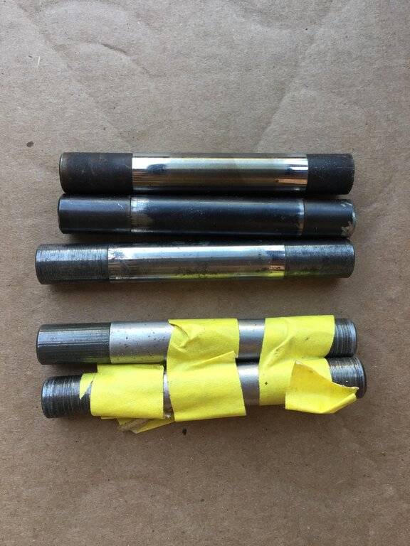

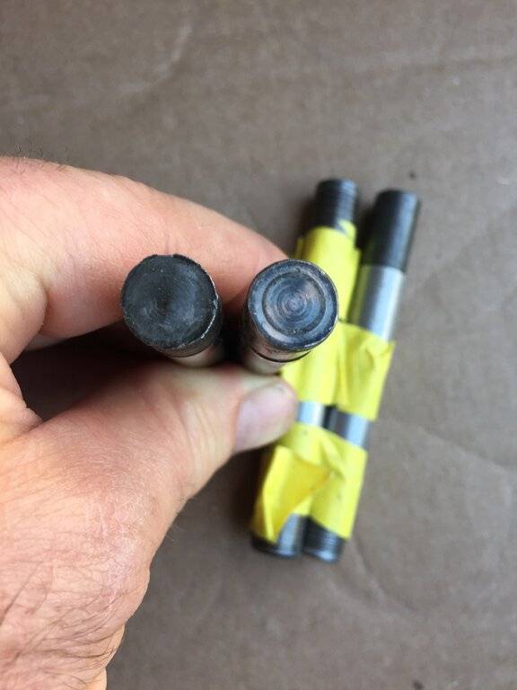

Please treat your fuel pump pushrod as a lifter, must go back in the same direction as it came out. New rods will fail if not an NOS part. Lube as you would a new lifter. Last two cars I had in here with failed were replacements from omp cams.
Here are a couple of photos, NOS Chrysler are the longer, aftermarket are the wiped shorter.
