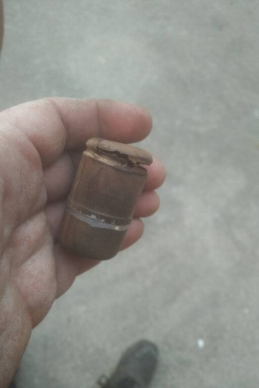

Is there an off-the-shelf replacement? As I suspected, my float sank. I seem to remember this was a part you could still buy at a Ford dealer a decade ago. I also remember zip-tieing a carb float to the sending unit arm once as well. What have you guys used? You'd think by now someone would have come up with some kind of universal gas-proof foam brick you could just attach.

Thanks all for the suggestions. I should mention that I knew the sender itself was still functional. As you can see from the home-made pick up end, someone was here before me. They actually did a pretty decent job, so I left those parts as-is. Hard to believe the float wasn't showing deterioration when they were there the first time. Here's what I ended up doing...
I wanted to get the car back together ASAP , so I did take a stab at soldering the split, but the metal is so contimated (on the inside), good luck with that.
Hit some old-timey parts houses and no dice. On a whim, I tried an O'Reilly where I found a good employee! He found this in their catalog for the princely sum of $6.99. I'm going to order one in case (when) my fix goes kaput. Good news is, you can pull this sender without dropping the tank, and perhaps with about a 1/4 tank of fuel.

In the mean time, essentially JB putty to the rescue. My bucket of water test told me it would still float with ease. Fuel gauge back to functional now. Thanks again for the suggestions, hopefully someone can benefit from the O'Reilly link... I'd take that over brass anyway.
