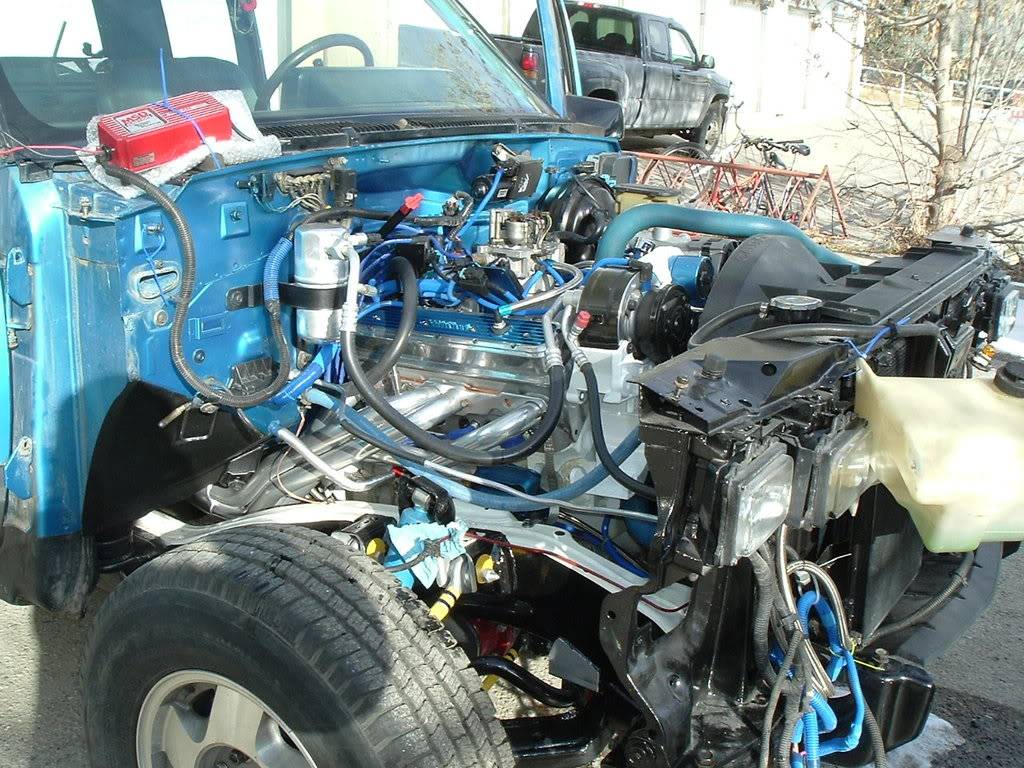

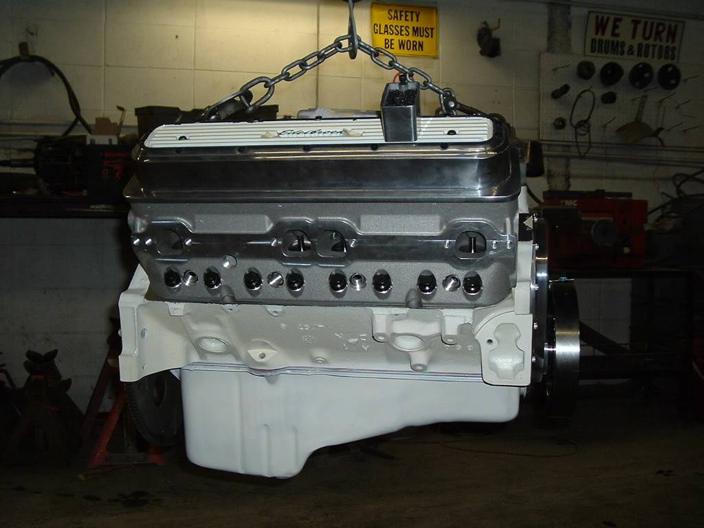

put duals on my built gmc….lost low end torque...replaced duals with single 3 in..low ends torques back...duals aren't always the answer..real world ****....
Not buying it. Nor are all the motor guys at Hot Rod. I go to race tracks NHRA, F1, NASCAR, Moto GP, never heard anyone in the Pits saying put back pressue into my exhaust system I want to go faster...
never said you had to...like l said..my real world ****,,not yours
