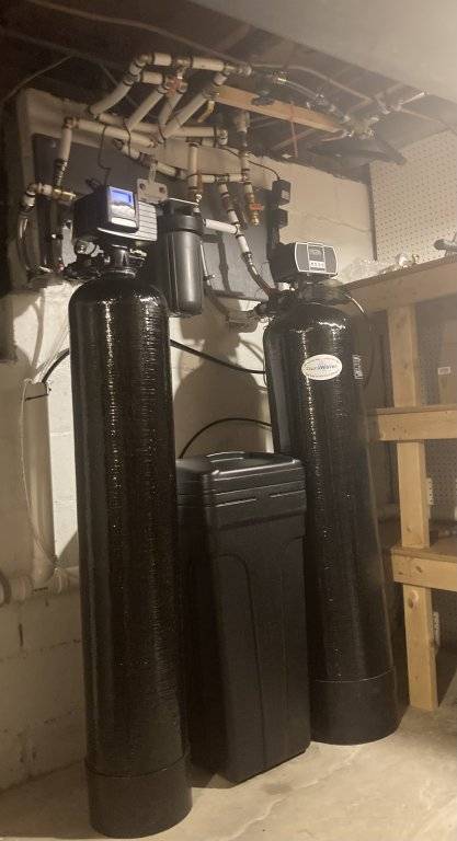

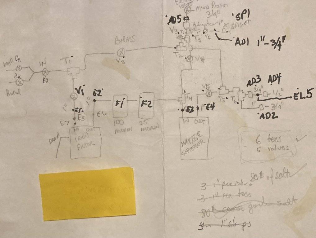

I have installed a whole house filtration and softening system in the house.
It consists of an iron filter (that backflushes), a 100 and 25 micron particle filters and a water softener.
Pex pipe is easy to use and I have a combination of crimp and push on fittings.

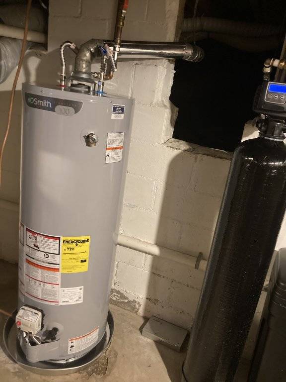

Next is to replace the water heater as it appears to be made in 1994. I tried to drain it and a dribble came out.
DAMN!!!!! The water is that bad an SD? I could probably see if you lived in Michigan. Lol
Nice work……
Looks like you've got the same setup as me. When we moved in, whenever you turned on any water source, it smelled like septic. Apparently there's a lot of sulfur in the ground water in MS. $3500 later and we can take a shower without wanting to puke!
