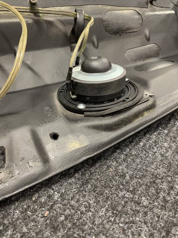

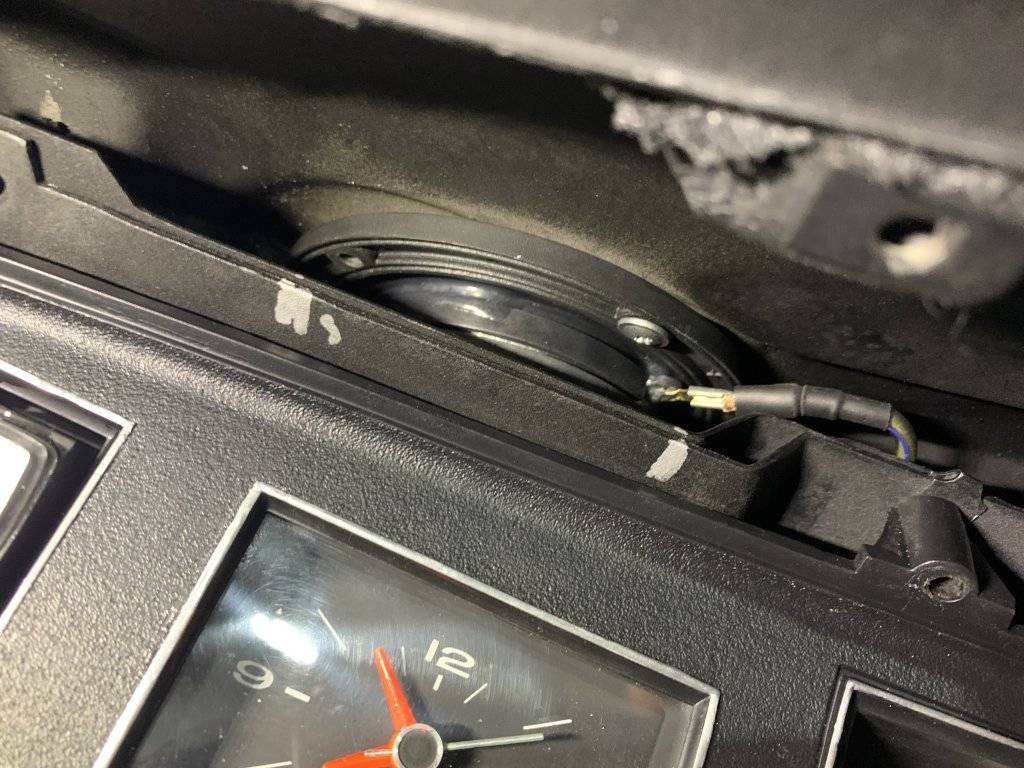

If I remember correctly the grill is metal comes out from the top. Should come out without interfering with windshield. It screws in from bottom where there is a mounting bracket that sandwiches the dash mtrl between speaker grill and mounting bracket. Then the stock speaker mounts to the mounting bracket. I dont rember if the cres that connect to the grill also go through the speaker. Passenger side would not be hard but the drivers side is tight. Gott pull the cluster to get at the bottom mount screws. Evebn then the tolerances are tight and force you into speakers that are super puny or like I did just wide range tweeters. Depth on drivers is maybe 2-2.5" but the issue is width. the stock speaker has a narrow magnet and just clears the dash mount for the clock. The speaker in the pic was too wide at the magnet. Replaced it with a smaller one. Perhaps a nice neodymiummagnet 3.5" would work . They have small magnets but not many people make them. Maybe Home

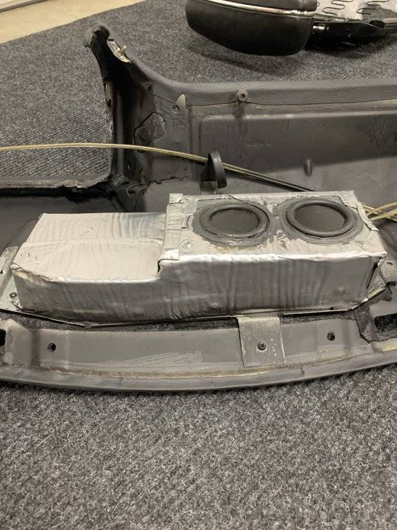

Yes, for me I replaced 4x10 with 2 4x6 plate speakers also and made an enclosure. works pretty good

I was working with another guy who is better a electrical than myself and was on a schedule. But If I had more time it is very likely I would have chosen to cut the dash support behind /on top of the clock to make a 3.5 fit. That would have eliminated the magnet width issue. Depth still would need <=2" because deeper hits the clock. Well that is fixable too. The clock mechanism should be replaced with a quartz conversion anyway. Smaller for sure. Amazing how such a big car have such packed spaces.
