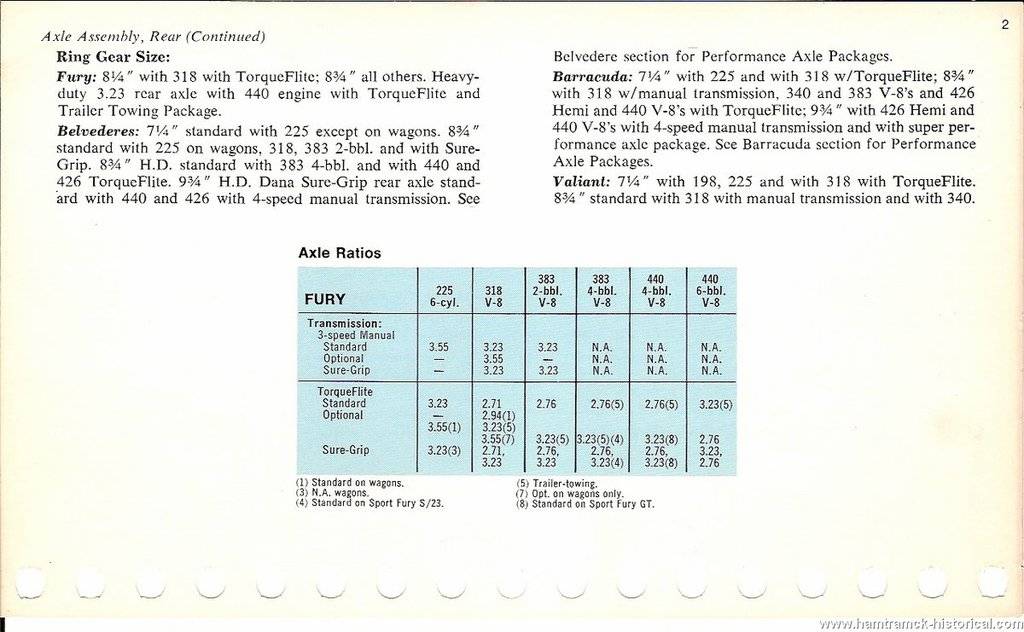

Here's the specs for a '70 Fury.
Note also:
That most police cruisers of the era had 3.23 gears. Exception would be that many highway patrol vehicles in open freeway applications would have 2.76 or 2.91 gearing. Think Texas, Arizona, Utah, New Mexico, Nevada etc.
