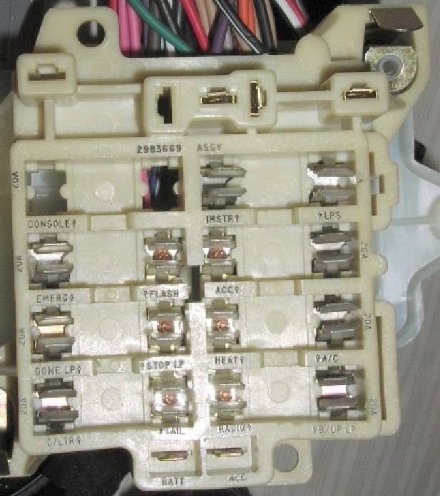

The fuse block is clipped to the firewall. See the top right corner (best pic I could find). There is a clip there and at the oposite corner. This is often not clipped... It can be hard to get it in place and pushed in far enough to clip it, so a lot of guys just leave it hanging.
Success almost! Pushing upward until I felt a “click “ then pulling down brought the fuses into sight. Thanks for the advice. I pulled and visually checked every fuse . They looked good to me as not being burned through at their middle. The problem I’m chasing is a loss of dash lighting and tail/ parking lights.
