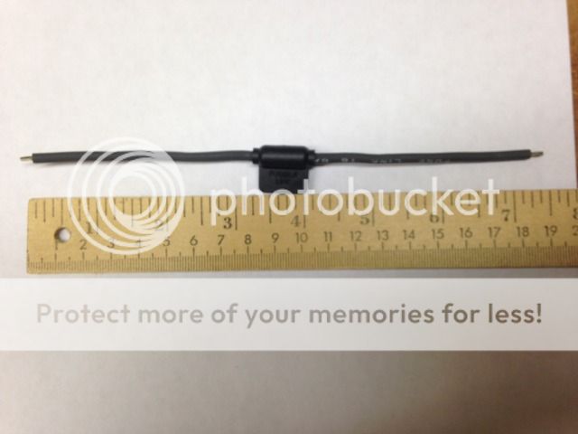

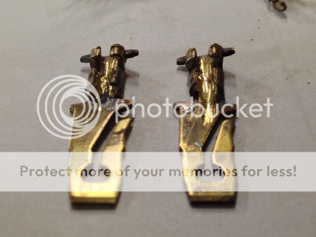

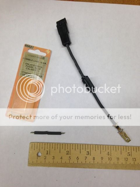

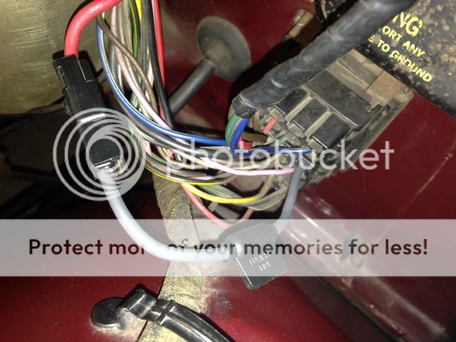

Advance Auto did cooperate today. The fusible link came in and I was able to make a pigtail up this afternoon. I wound up trimming 1.75" off the 7.5" length = 5.75" (about 1/4" longer than the original wire) and then crimping on the used terminals. Soldered the #16 fusible link wire (quickly) just at the very ends so it wouldn't wick inwards. It worked out well and car is functional once again. Here's a few photos. Didn't think to swap out the black rubber tag for the original yellow one though. :BangHead: Good idea but still...looks way better than how I first planned on fixing it. Thank you again John...for all your help. The photos of the terminals you posted were the key to fixing it right. That showed me just how to get them out of the connectors. Never used this type of terminal at Xerox obviously... :) Thanks to everyone for your patience and for all the time you took to explain things to me. Now I know the WHOLE wire is the fusible link...not just the center that melted/burned up.

any 16 guage link would work
Yes and no. The biggest difference with the fusible link wire is the insulation. The plastic insulation on a regular piece of wire will burn or melt. The fusible link insulation is designed to contain the melting wire.
So, yes, any 16 gauge wire would work to protect the circuit, but then you take your chances with burning insulation if there is a short.
