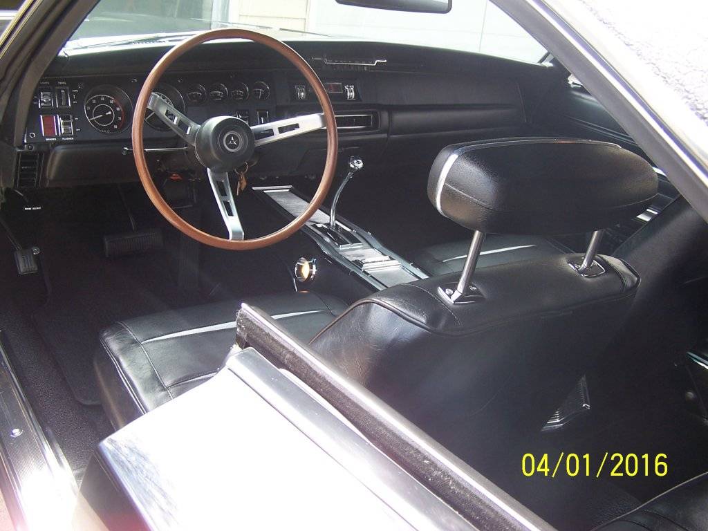

I used my factory console and shifter with the 5R45RFE truck transmission. You could use yours with the 904 or the 5R45RFE but not with the Nag1. The Nag requires its own shifter. I saw one guy in FBBO that was able to fit the Nag shifter into his 68 Charger console but it won't look stock. Here is a pic of mine. 2" higher than factory but no one notices.
Thanks for the photo! Looks great!!
