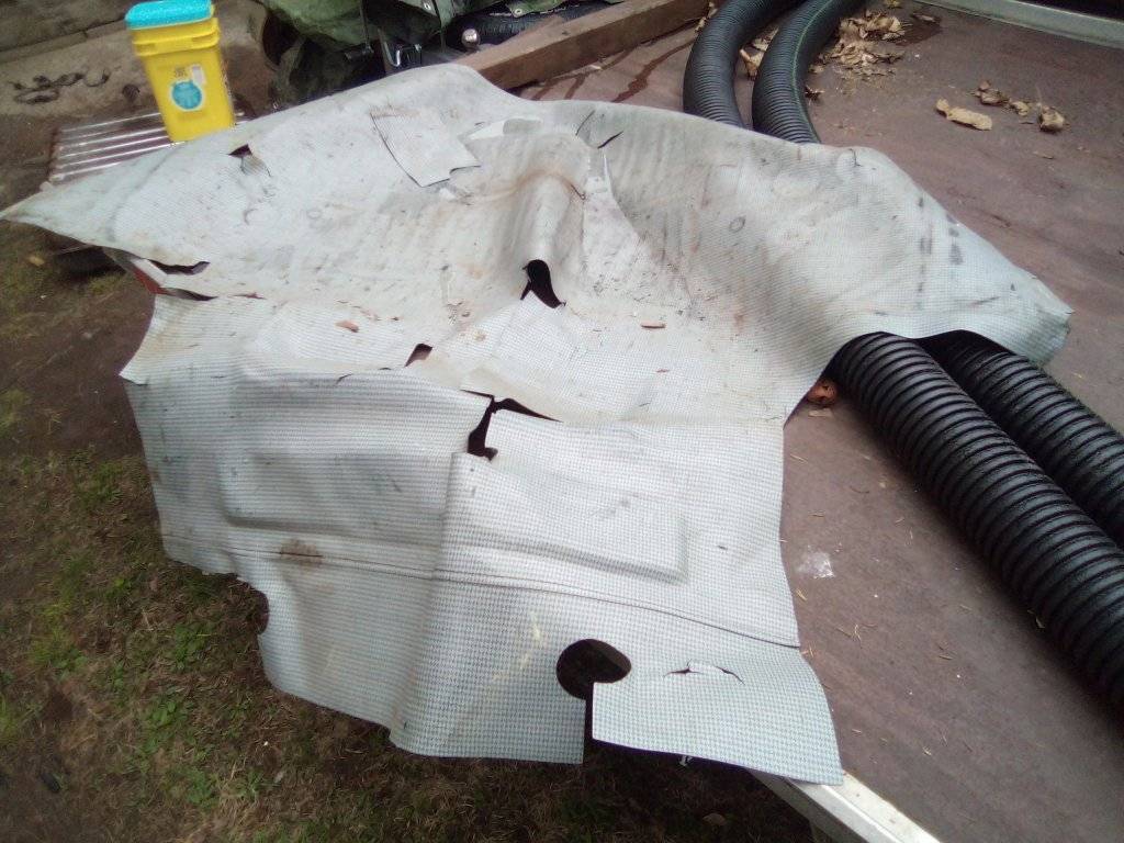

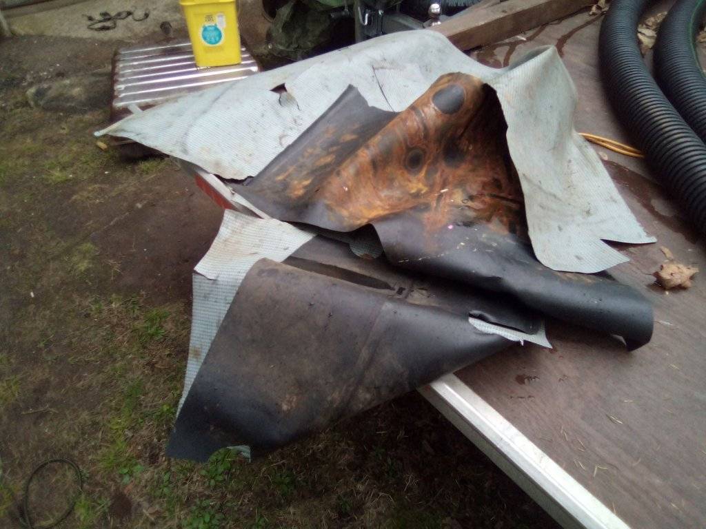

I'm back with a couple updates on the VIP project. I got some pictures of the old original trunk mat before it was unfortunately thrown away as it was just too far gone to save even though I wanted to do that, and a new one was ordered from Herb's Mopar Parts.

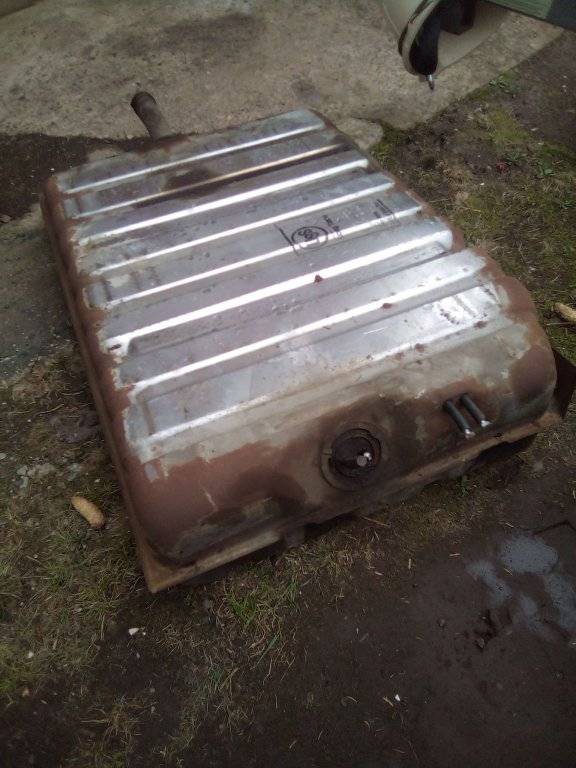

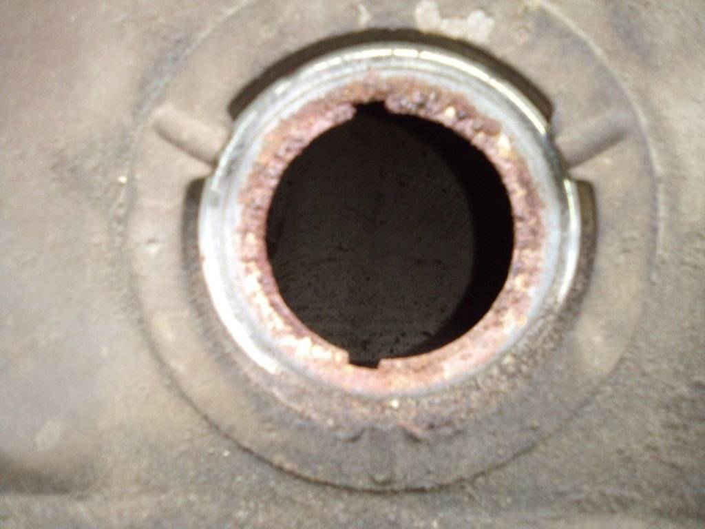

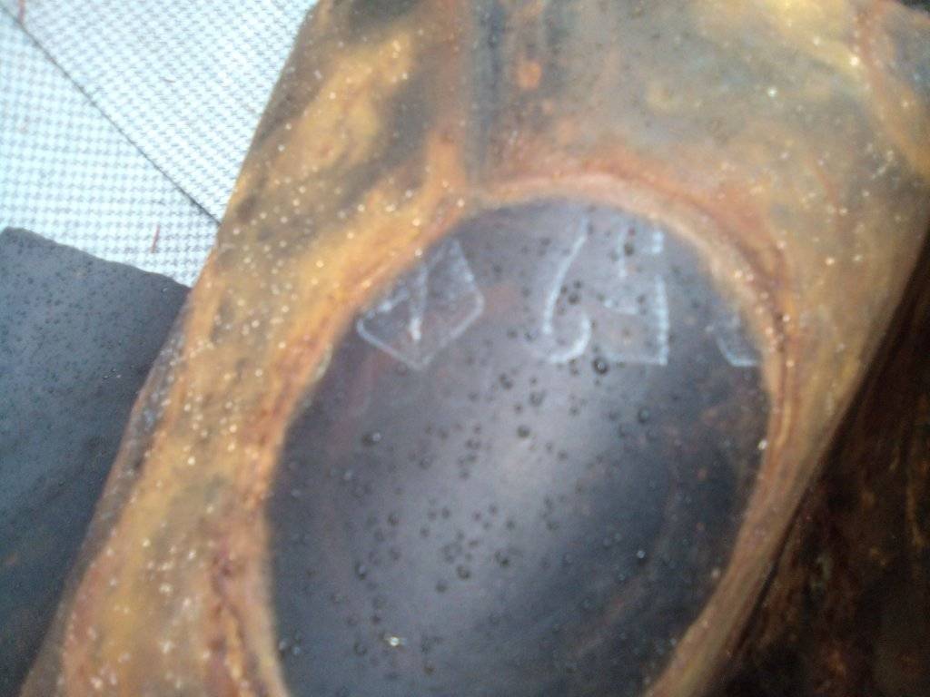

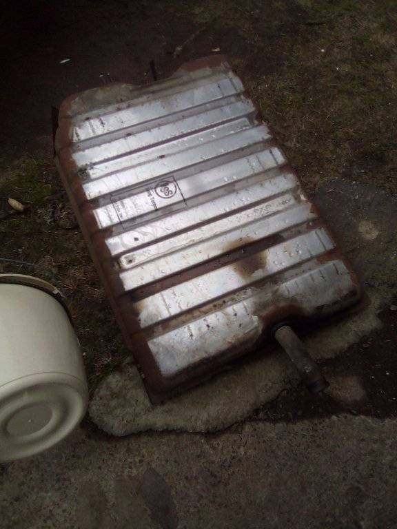

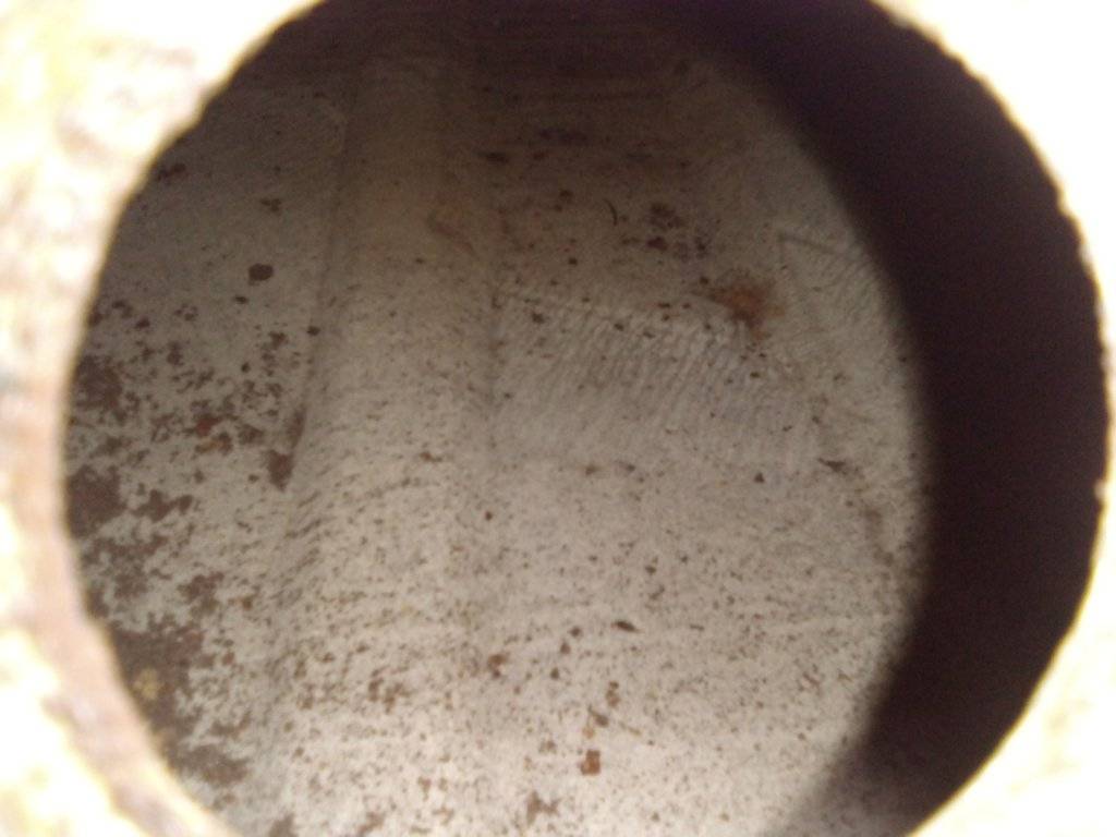

The gas tank has also been removed from under the car, the old gas just needs to be emptied out of it now. Depending on the condition of the inside, it will either be restored by our local radiator shop who also restores gas tanks if it is in good condition OR be replaced if it is not in good condition......

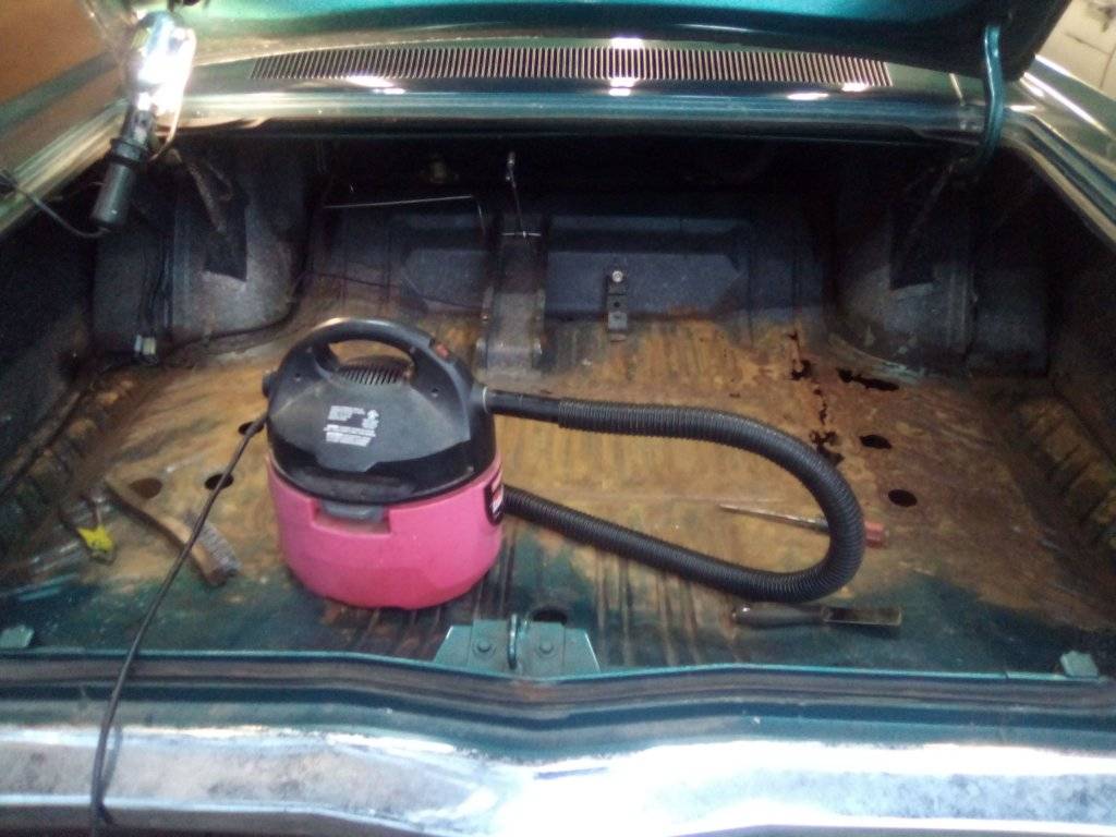

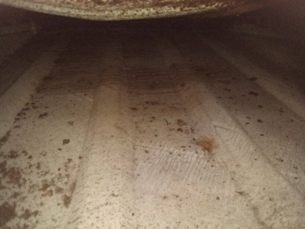

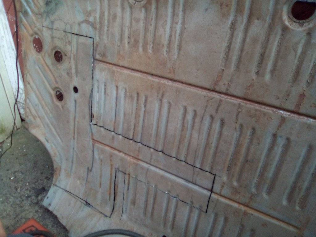

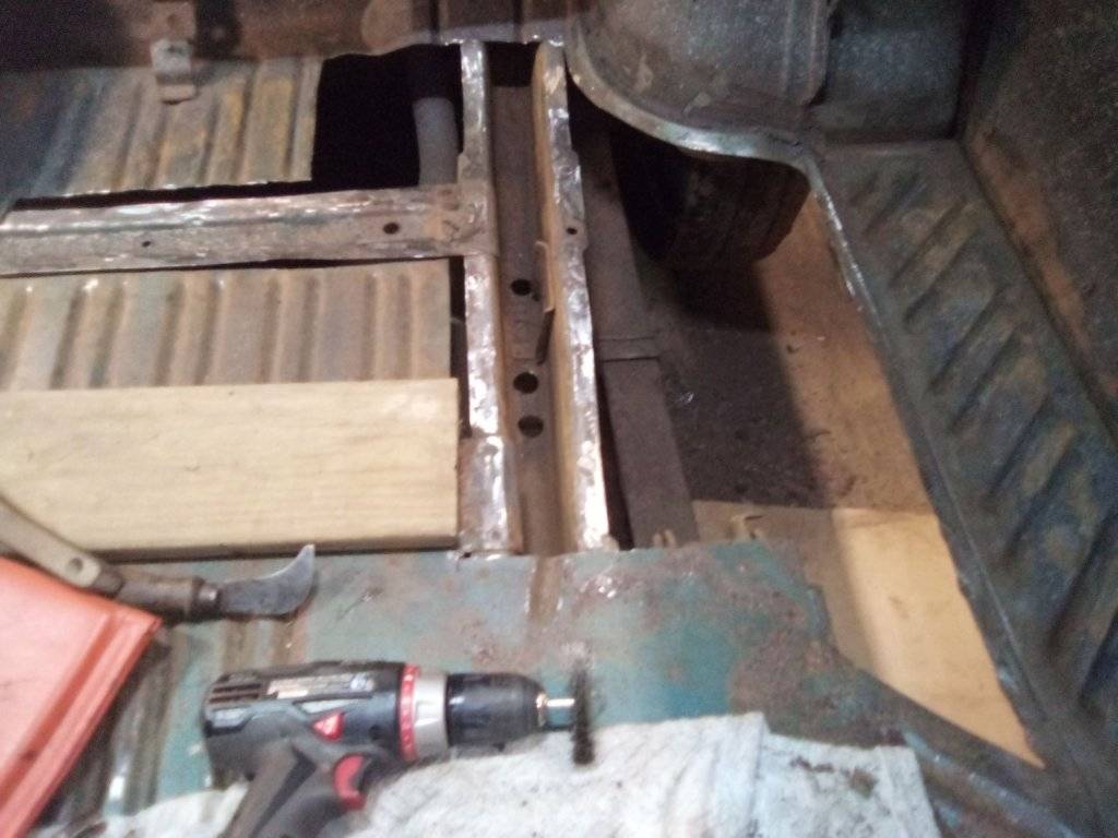

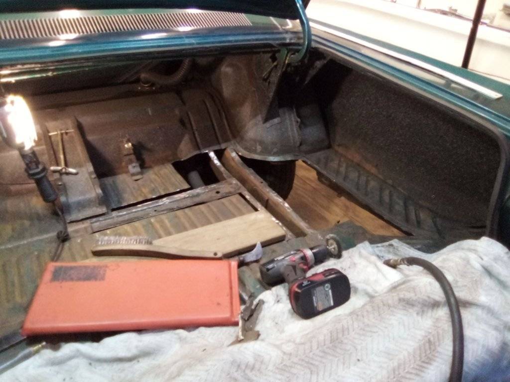

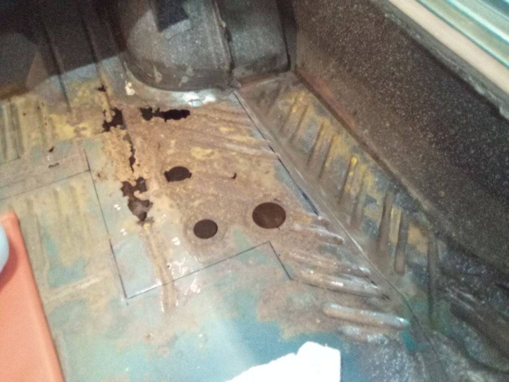

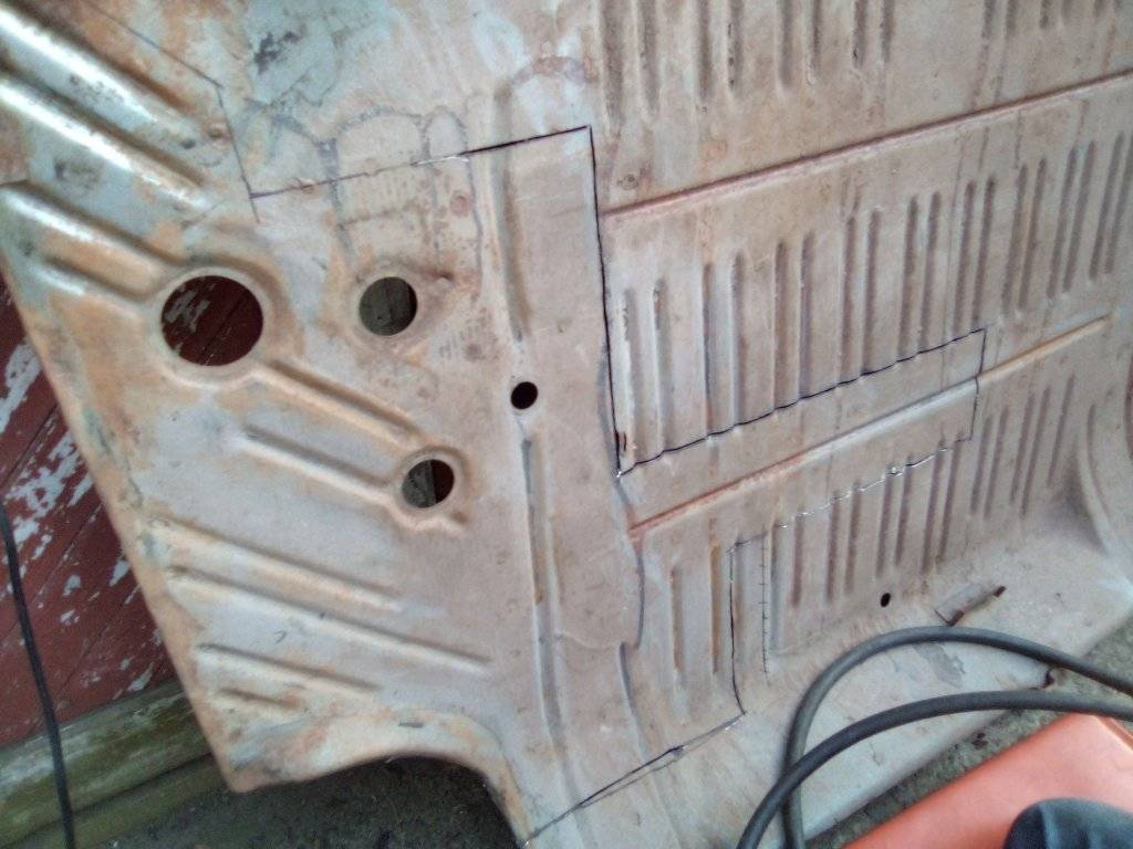

A final update on the car for now is that the trunk floor has been cleaned, wire brushed, scrapped and vacuumed to see where we need to exactly cut it out to replace it. An idea blueprint/template where we need to cut has also been made.....

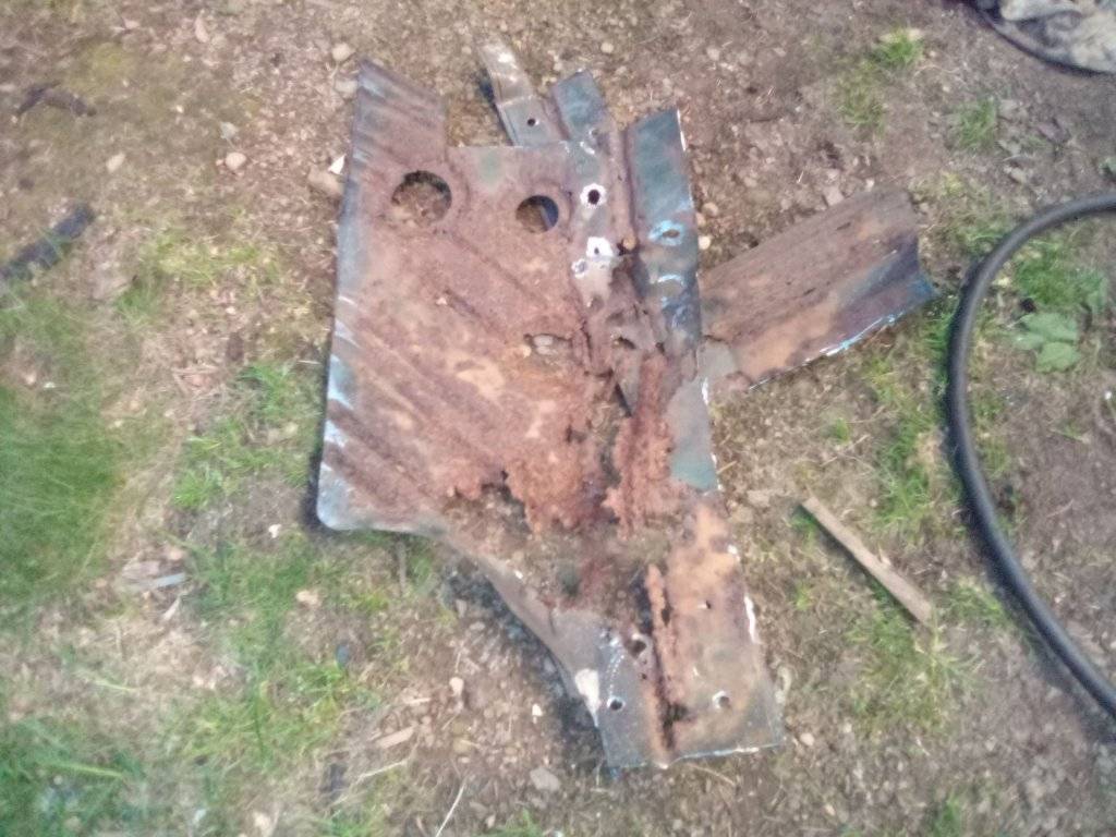

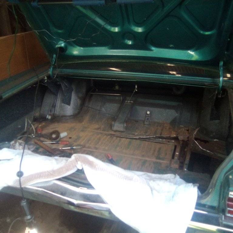

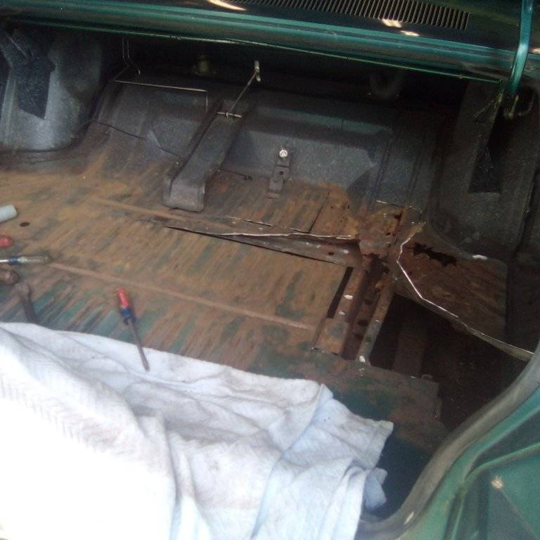

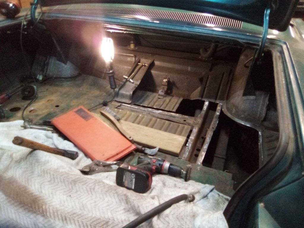

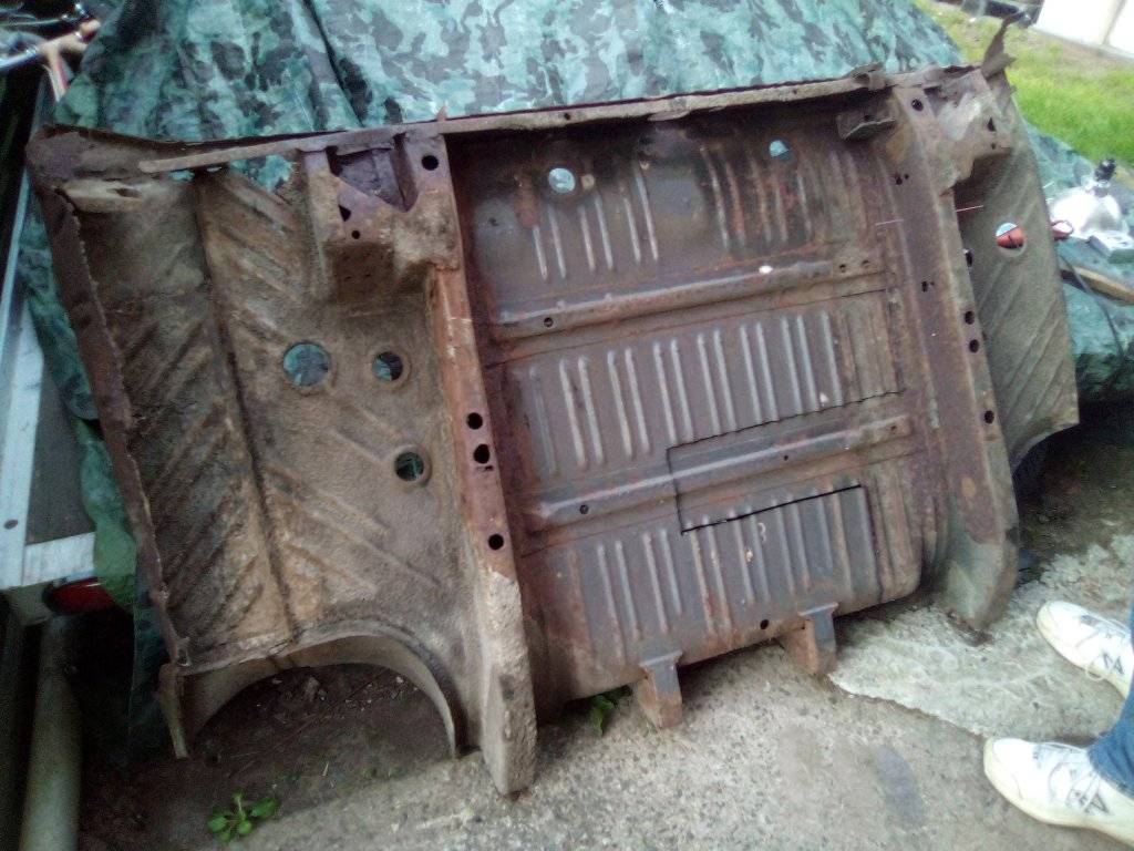

I got another update on the VIP. The old rotted out floor is now cut out, and the trunk is awaiting it's new trunk piece. The start of the cut out is in the first 2 pictures below......
The all cut out pictures are below......
Great pics! Are you guys doings the fab work (trunk)?
Hi Ron! Yes indeed, my stepdad is doing it. He is the one who cleaned up the whole trunk, already cut out the old piece, and will cut the new piece out and put it in. He is doing ALL the work, I'm just the documenter on this one.

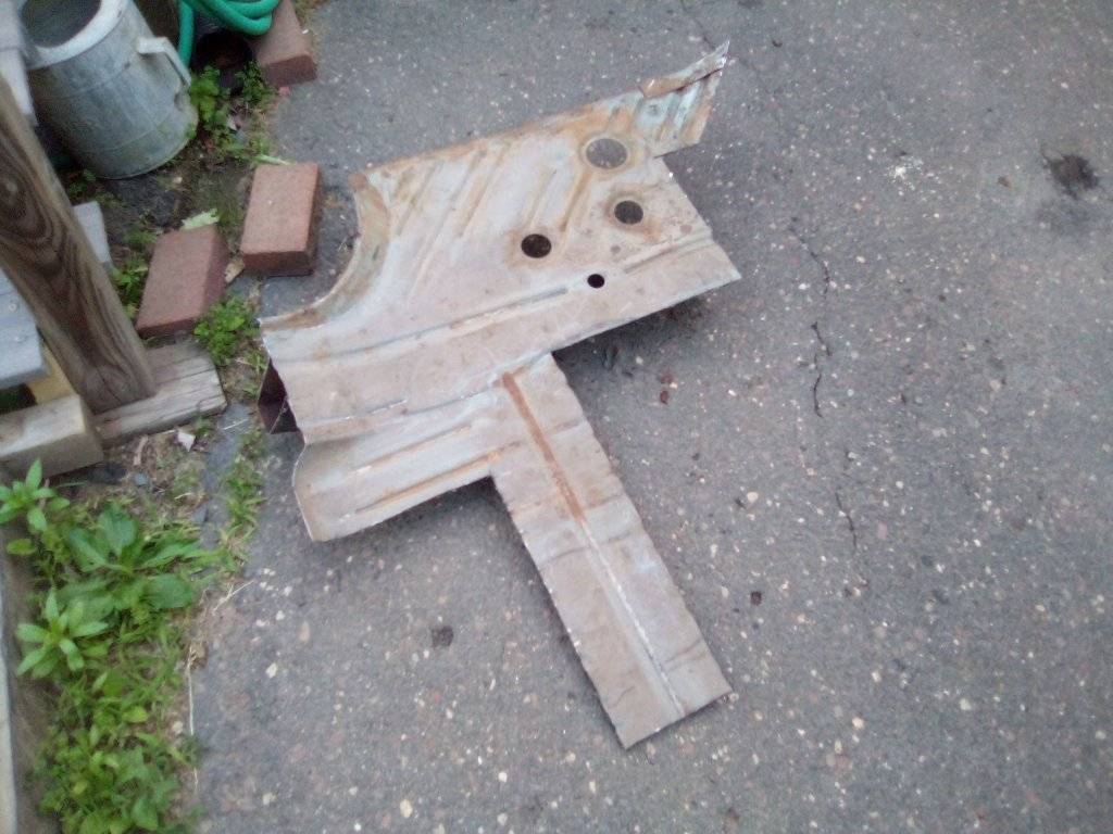

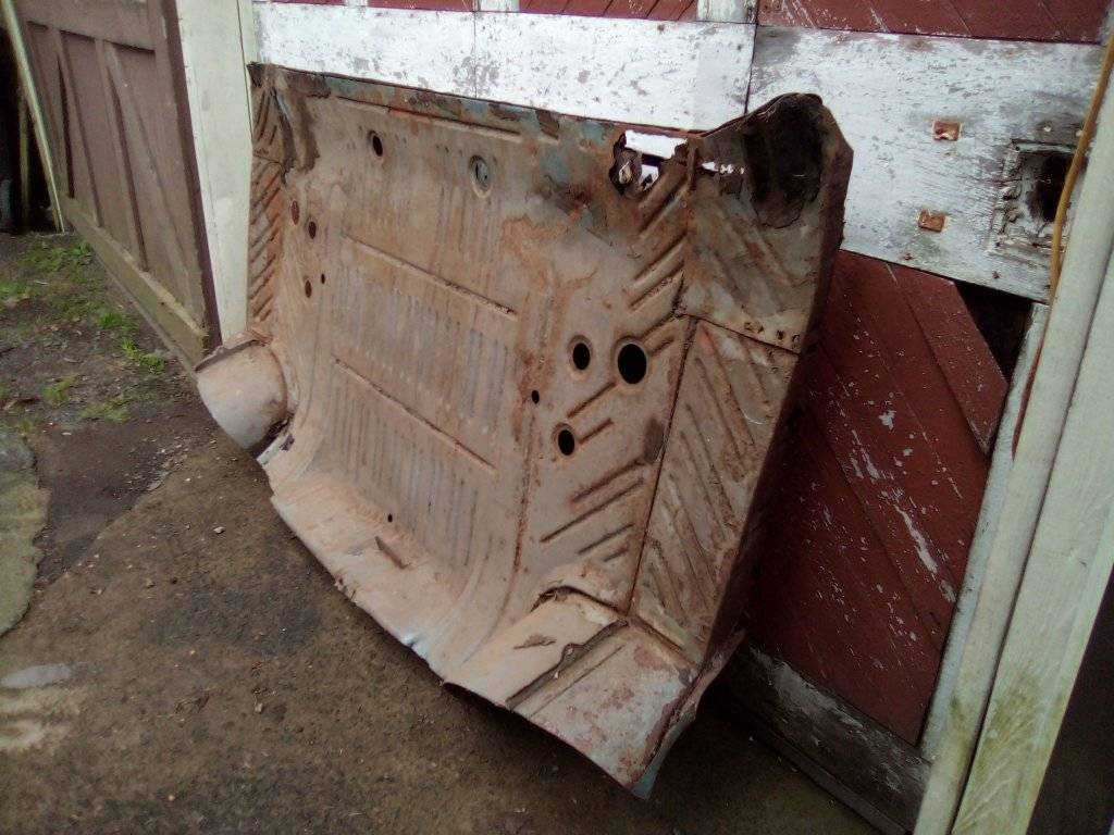

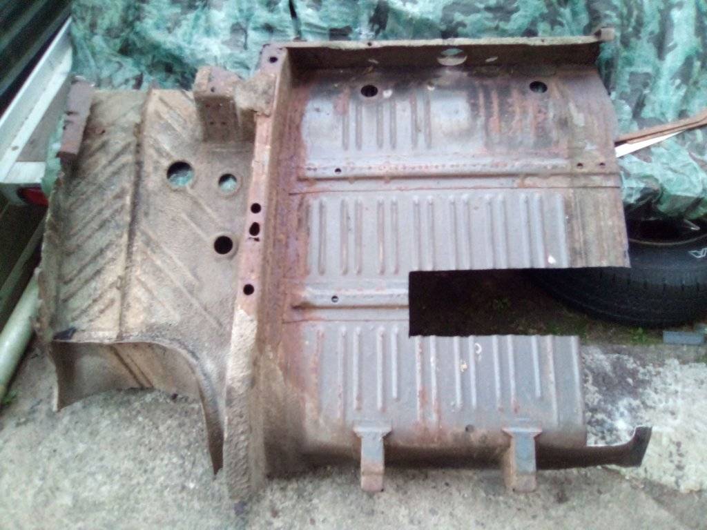

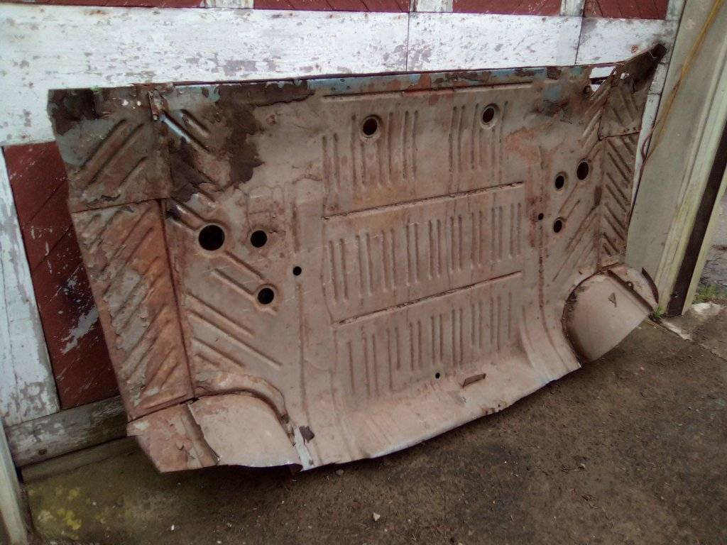

I got an update so to speak, but mostly change of plans on the car. Unfortunately we will NOT be using the original gas tank as according to my stepdad after draining the old gas out of it is too rusty inside to reuse, so we will be putting in a new one we have. Also as an update is that the new original parts floor we were gonna use we are NOT gonna use anymore, my stepdad says we will now be using this one below from a '66 Newport because the piece we need is in better condition. Otherwise this is all for now, more to come soon......

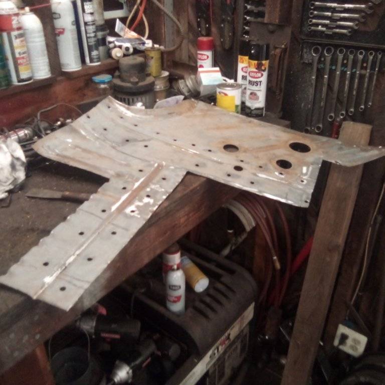

All cut out, now we just need to cut the frame rail off from the new floor piece because we are saving the original rail from the car. The rest of the new piece we didn't use will be saved because it is in such good condition and just in case we need it for any other future projects......

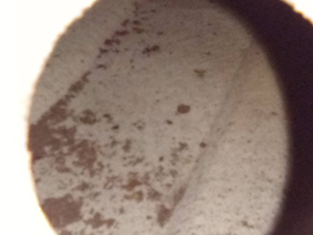

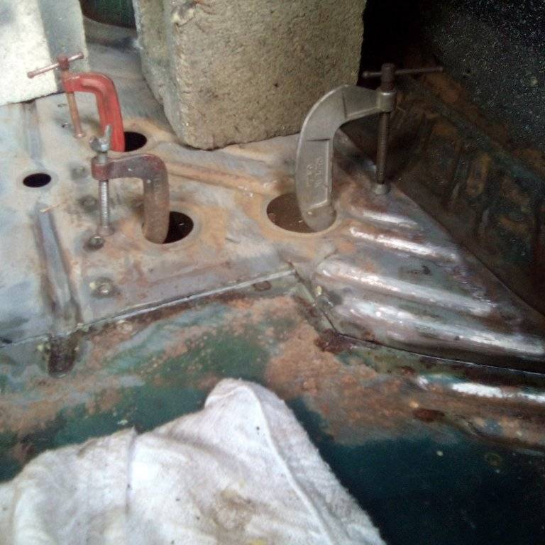

I'm back with an update on the VIP project. The spot welds from the new floor piece we are gonna use were drilled out and the frame rail piece that was under it was cut off as well. So very sorry for the blurry picture its not the best, I took it with my cellphone but hopefully you get the idea.......
Since the post above, which is actually a 2 week old project but I just posted it today the new piece was installed in the car just yesterday.......

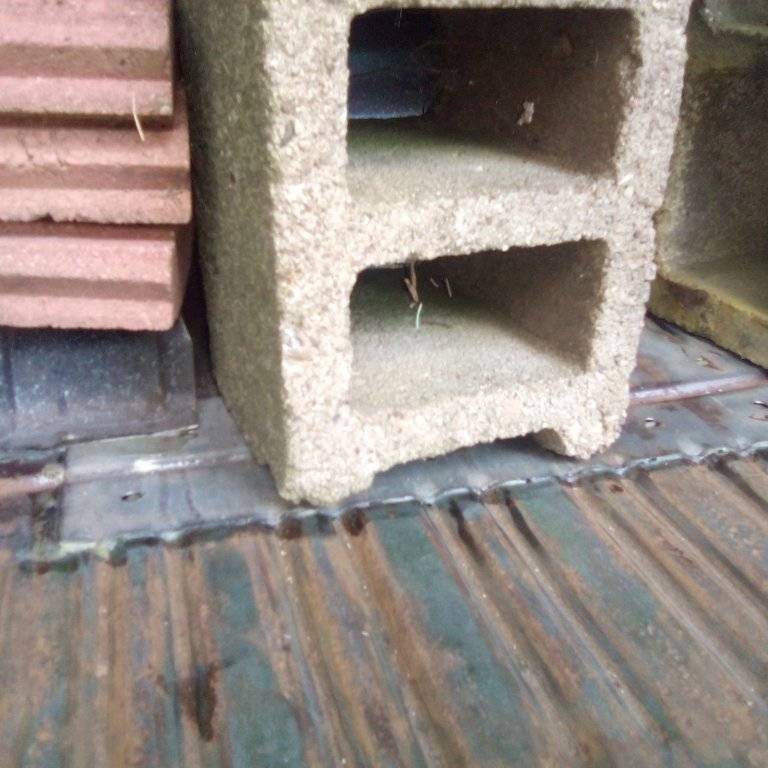

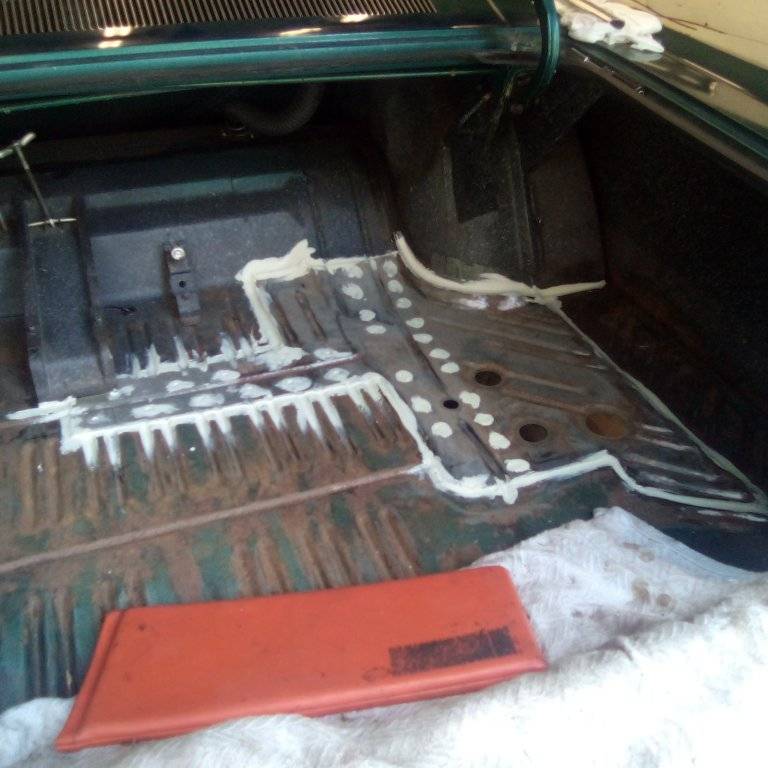

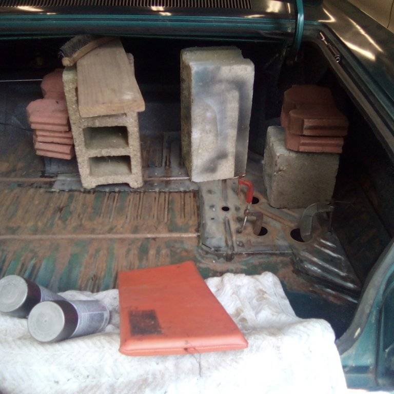

I got another update on the VIP project. I thought I posted this already BUT apparently not, however now that the floor is clamped and bonded in we took the bricks off and put some seam sealer on it. This happened today (or Thursday) of last week......
