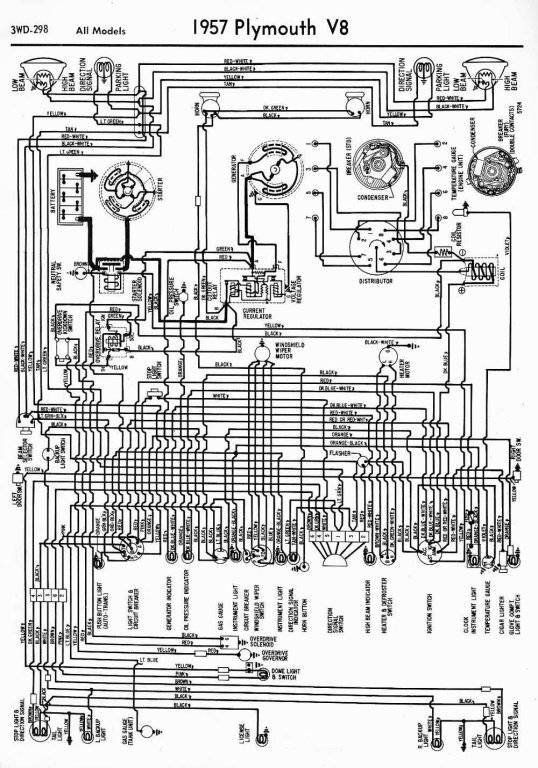

Better yet is look at the wiring diagram and see what powers the bulb.
Here ya go
