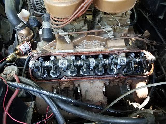

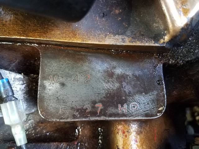

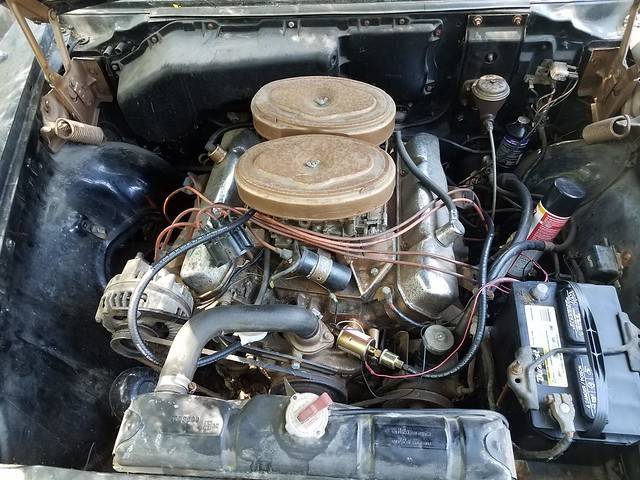

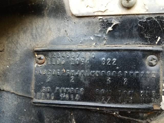

I was able work on the 300 (Sport) a little yesterday. I pulled the distributor to set a new pair of points on my friend's machine. It's obvious that the engine is not original, but is a 426. It has mechanical valve gear. Whats curious to me, with my very limited Chrysler acumen, is that the body tag doesn't seem to have the engine option listed. The only options I find on the tag are C=3, H=2, Q=3, T=2. I thought that even in 1962 the AB options were for the engine type?

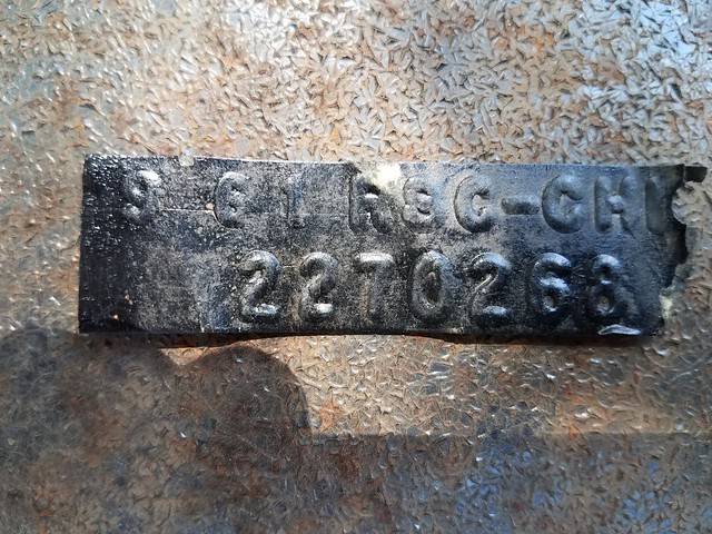

Also, I found this curious tag in the glove compartment - any ideas? It seems to be plastic.
20200806_110102 by Jim Harris, on Flickr

Oh, BTW, the head casting number is 2402286, 1962 413 Max Wedge?
Any way, I won't be getting back to the car for a couple of weeks. It's a 200 mile round trip from my house just to work on it.
2402286 413/426 Max Wedge 1962-63
And they used the 426 street wedge valve covers IIAC.
I agree, an HP engine, and max wedge, (I think they used the 4 bolt valve covers). Sorry I can't answer your questions. The tag, (my guess), looks like it came off a distributor.

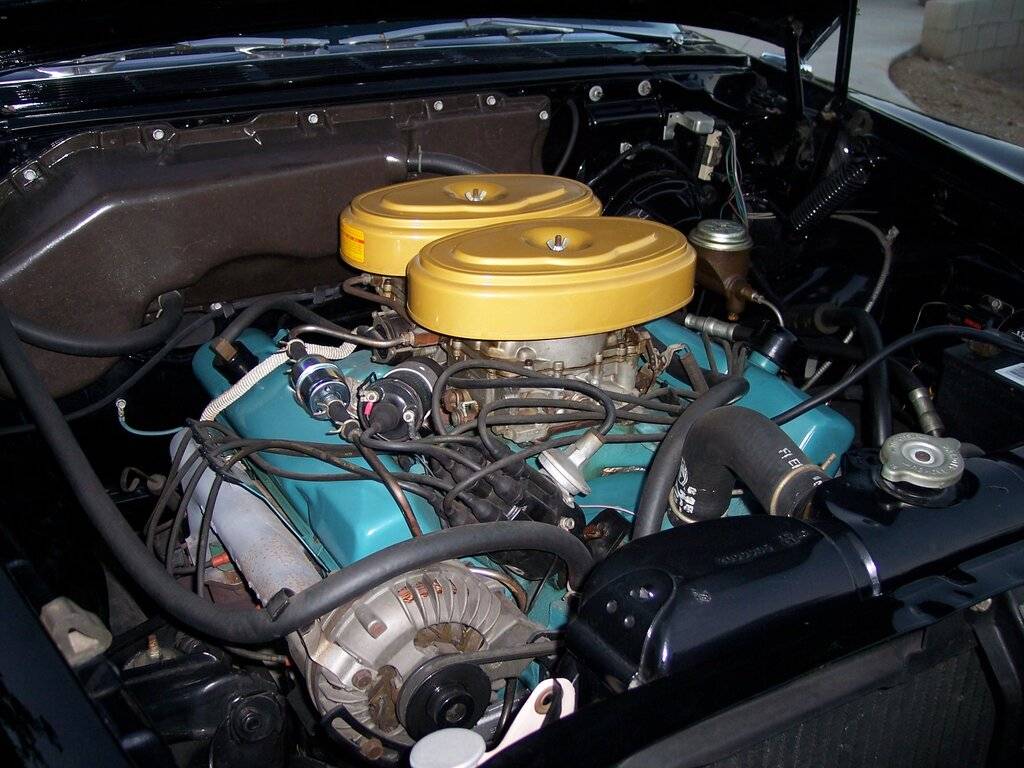

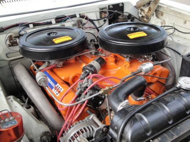

The '62 max wedge had bolt on pedestals for the rockers, '63 they were half moon cap type that appeared on later engines. Mopar built 214 super stock Dodge 413 in '62 and 298 '62 Plymouth max wedge 413 engines, these had the tandem carb mounts typically found on max wedge cars. '62 Chryslers were running 413 engines with inline dual 4BBL carbs such as shown above. Chrysler offered this as the standard engine on letter series cars for '62 and as an option on other models. Chryslers were not offered with the 426 wedge so someone has replaced the 413 short block and probably got a boost in performance.. Photo for comparative purposes is below:
Short version?
The block is a 1964 426 street wedge. $
The heads are max wedge early version with 4 bolt valve covers and no rocker stands. $$$
What exhaust manifold is on that car, it's not the soldier upswept max wedge ones
If memory serves me correctly, the 380hp Chrysler 413 with in line carbs for '62 used the Stage 1 heads but not the same exhaust manifolds as the 413 Plymouth and Dodge stage motors. Those got the upward arch manifolds and split H exhaust and were rated at 410 or 425 horses. The Chrysler engine was a street capable engine whereas the 410/425 hp engines were primarily a track engine. Particularily the 425hp variant at a 13.5 comp ratio, it would not run on pump gas. The 11.5 comp ratio for the 410hp variant was marginal on premium fuel.

The exhaust manifolds appear to have the attach points for the heat stoves for the long tube ram. If there's anything I would change about the engine bay it would probably be to get some proper exhaust manifolds. I am tempted to keep the car but we could use the money to help with refurbishing the house. Technically, the car belongs to my niece but I have been getting all my late brother's cars running and moved off the property. The 300 is number 5. I have kept his 1966 Valiant and just drove it 1,100 miles from so. CA to WA.
The part numbers for the '62 380 hp exhaust manifolds are 2768250 for the right and 1739600 for the left, those numbers are usually the casting number for the manifold, so check to see what you have.

Reference your tag pic - that is indeed a seat spring tag. 9-61 is the date; and since your car fender tag shows 11-16 as the SPD, your springs are likely the originals to the car.
RSC is the spring manufacturer (Roberts Spring Company, IIRC) in Chicago, and the p/n 2270268.
