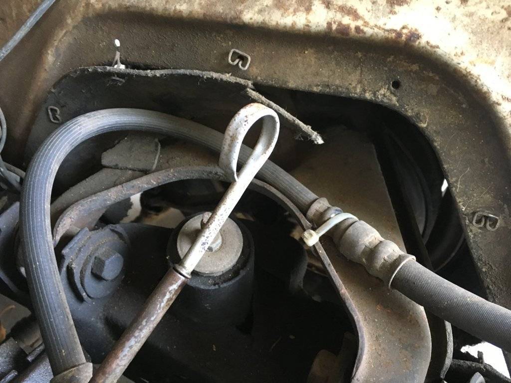

It blows me away that they ran the harness over this sheet metal bracket like this. It seems like a pretty sharp edge that would have done some cutting over time but I guess not because mine is run the same way and is 50 years and over 150K in and is still fine.
Yea that spooked me too, but again, of all the stuff that does work on this car after 100k and 50 yrs, the AC is one. I'd at least have had it epoxy coated!

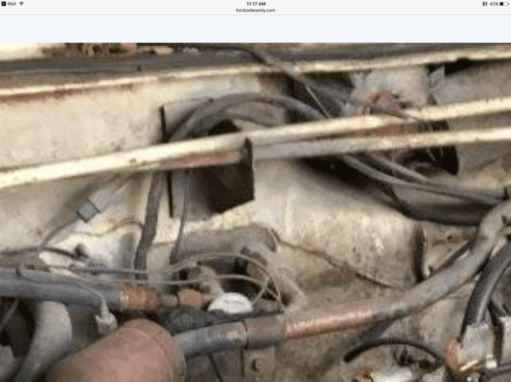

The wiring is iffy to say the least. It's there, it's dried out and cracking. Something I really don't want to take chances with but need to take a little time and plan. One weird one: a gray wire with a clip on the end of it that was run underneath the pass. side valve cover gasket.. obviously connected to nothing. I'll have to figure what that was supposed to be.

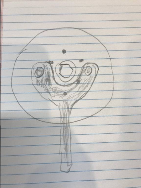

cheese and rice...I have practically every pan but the 187.
933, 971, 402... :BangHead:
Sorry my man.
Thanks for looking, man! I'm pretty sure it's a 187, if I crawl under her and find out I'm mistaken, I'll let you know!

cool man, good luck!!

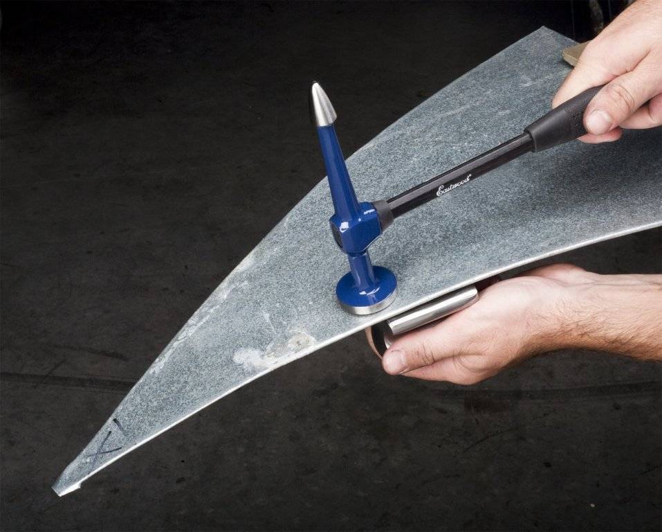

Don't be afraid to use metal hammer and dolly, you'll be amazed at how easy it is to shrink metal back into place rather than stretch it further the other way.

Thanks Matt! I'll give it a shot. I've been meaning to work a bit more with metal lately and this is likely a great excuse to start.

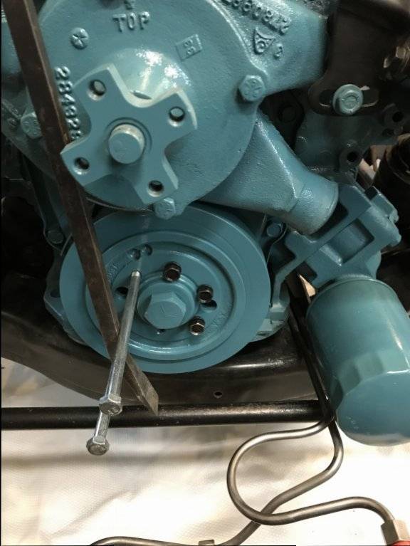

Having never pulled a harmonic balancer off an engine still in a vehicle, any of you got tips for stopping rotation of the engine while trying to loosen the bolt? Haha. Dug my own grave on that one.
Impact wrench the best but if you still have the radiator in you may not have room. Other option is get two longer bolts (grade 8) and screw into your pully bolt holes. Then use a long pry bar to hold the engine from turning. (The bolts in the photo are for demo purposes only. They are too long and will bend or break)
There is also two holes in the balancer. The ultimate would be a spanner wrench with two pegs that match the balancer holes, but that's probably impractical.
