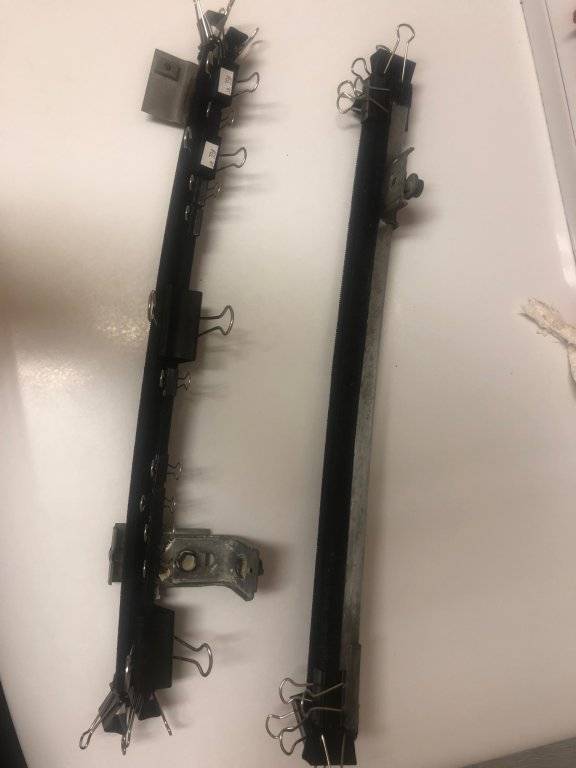

Used 3M 77 Super Adhesive. Worked great but had to continuely use turpentine to wash hands to protect the felt, fingers stick to everything including the bottle(s) of beer your using for inspiration, three stage process; bottom, one side and then the other, lots of masking tape, use Paper Binder Clips to secure while drying, lots of time, let set and then do another side, swear a little here and there but in the end, worked great!The Glass Window Run on a 1965 SF used Felt glued to the Metal Channel vs. a rubber insert. As part of my restoration project, I need to replace the Felt but am not sure what type of glue to use. It should be tacky, hold the Felt in place, weather well and cure to a flexible adhesive. My thought is to use Gasket Adhesive. Any thoughts?
