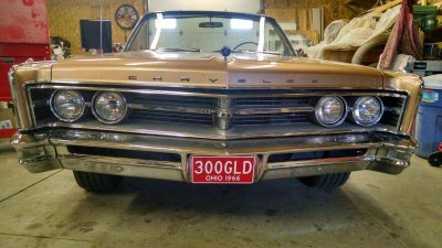

Goldie has a new name plate.

I have been thinking about a custom name plate. I should be able to registry this one. If not it will just be my front plate.
That's awesome. Let me know when you're up for cars & coffee.
