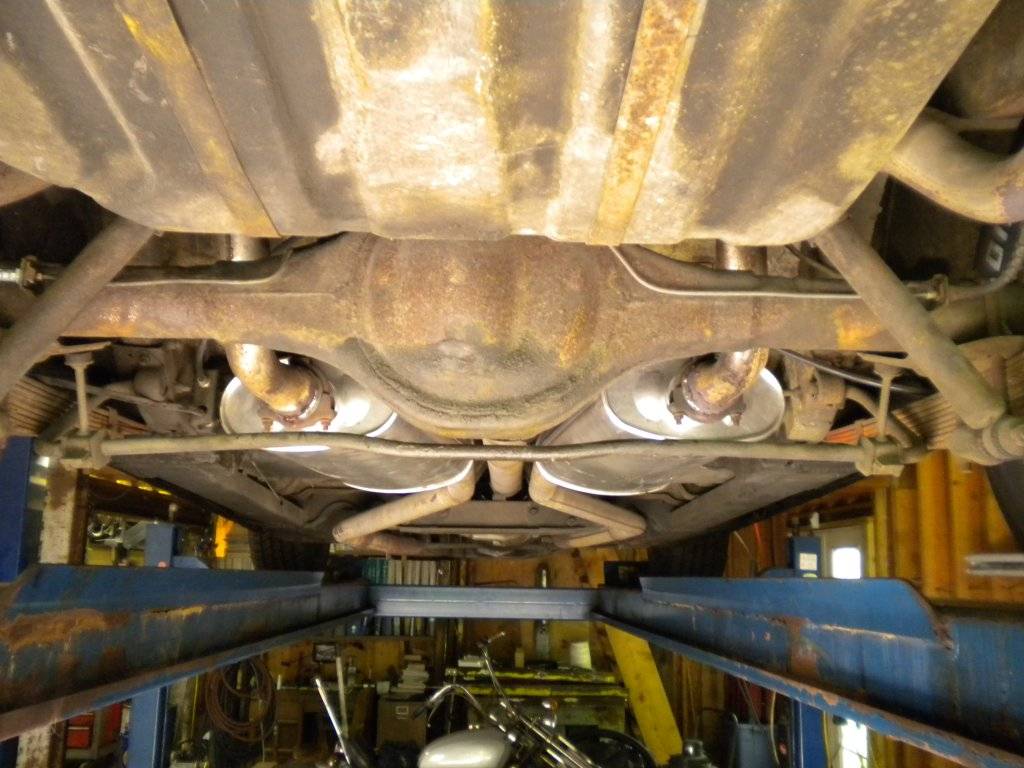

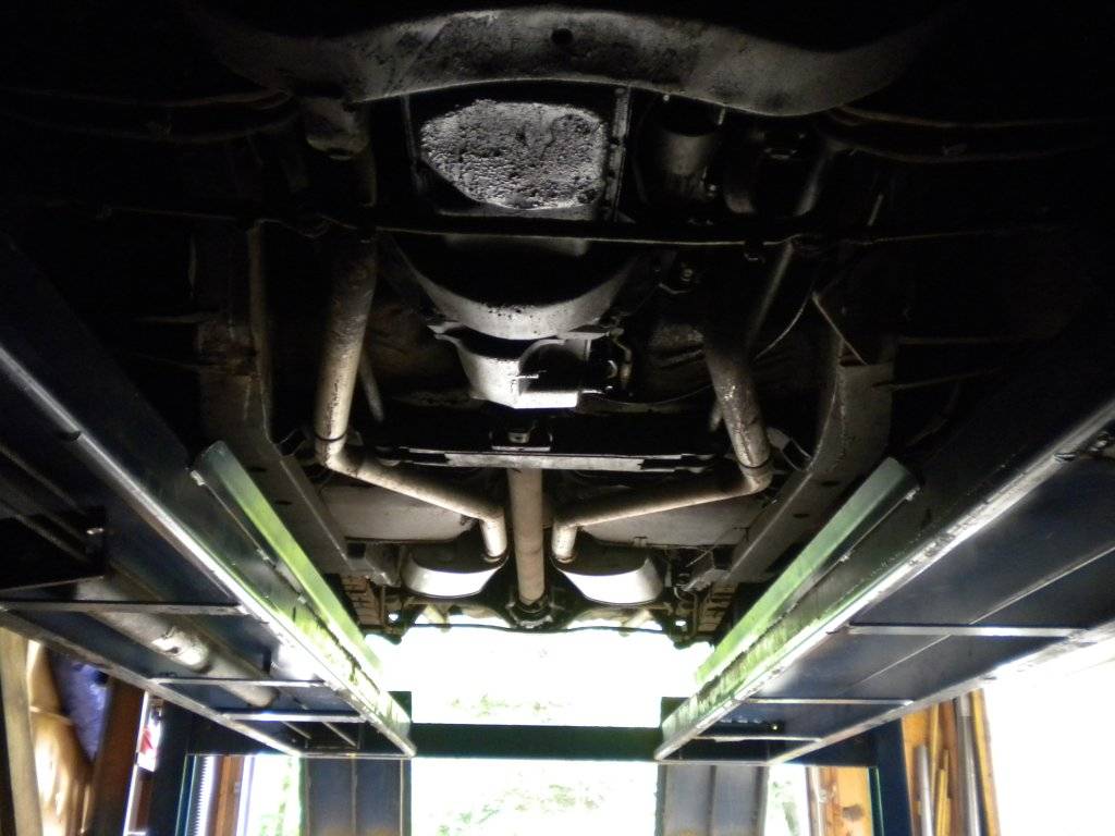

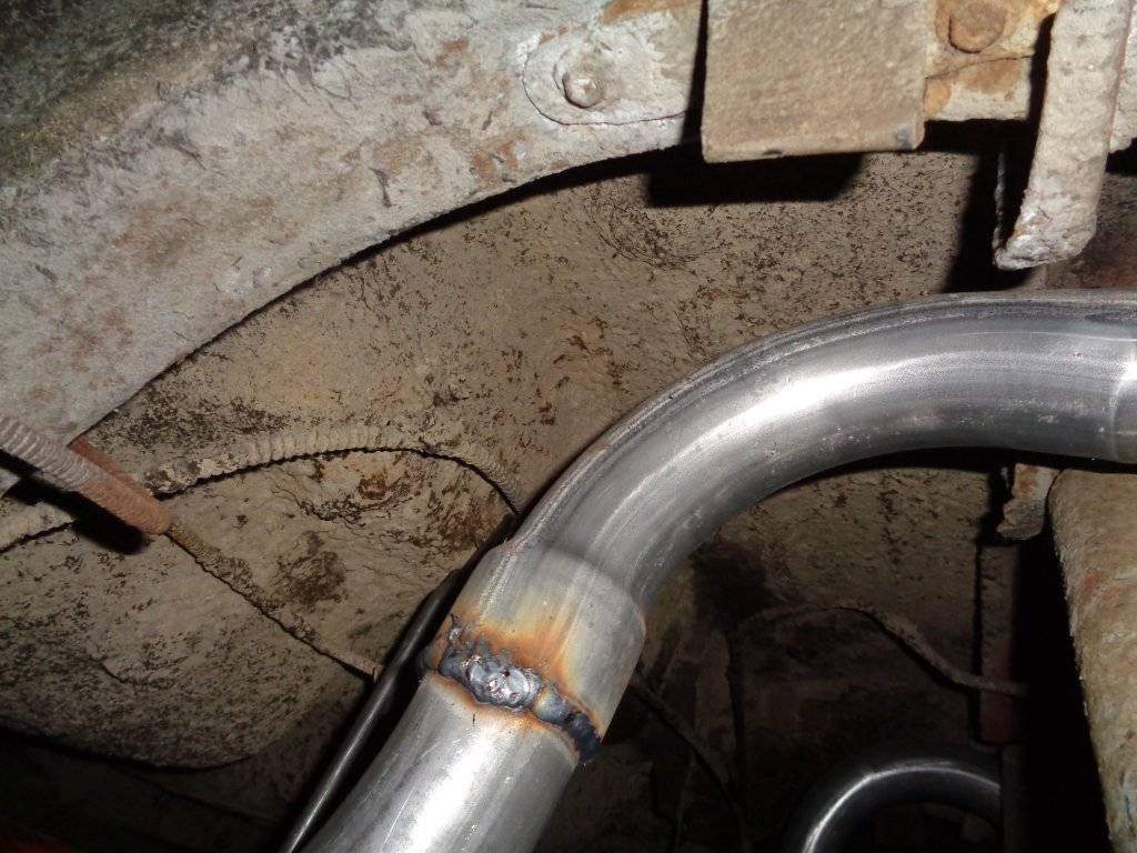

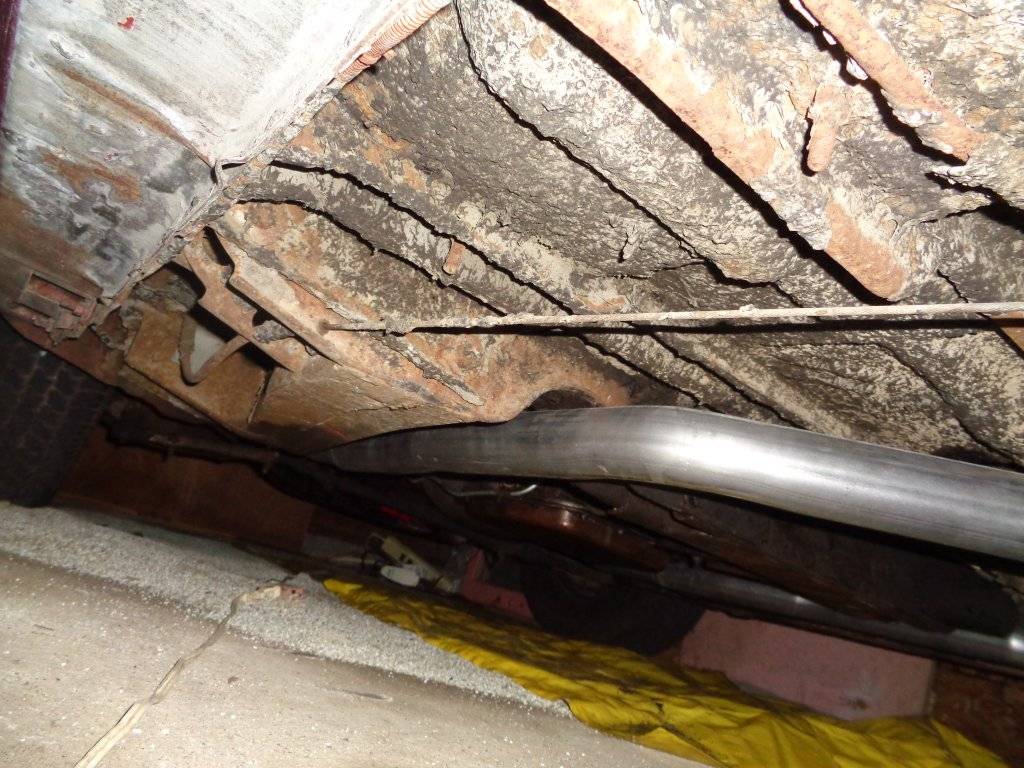

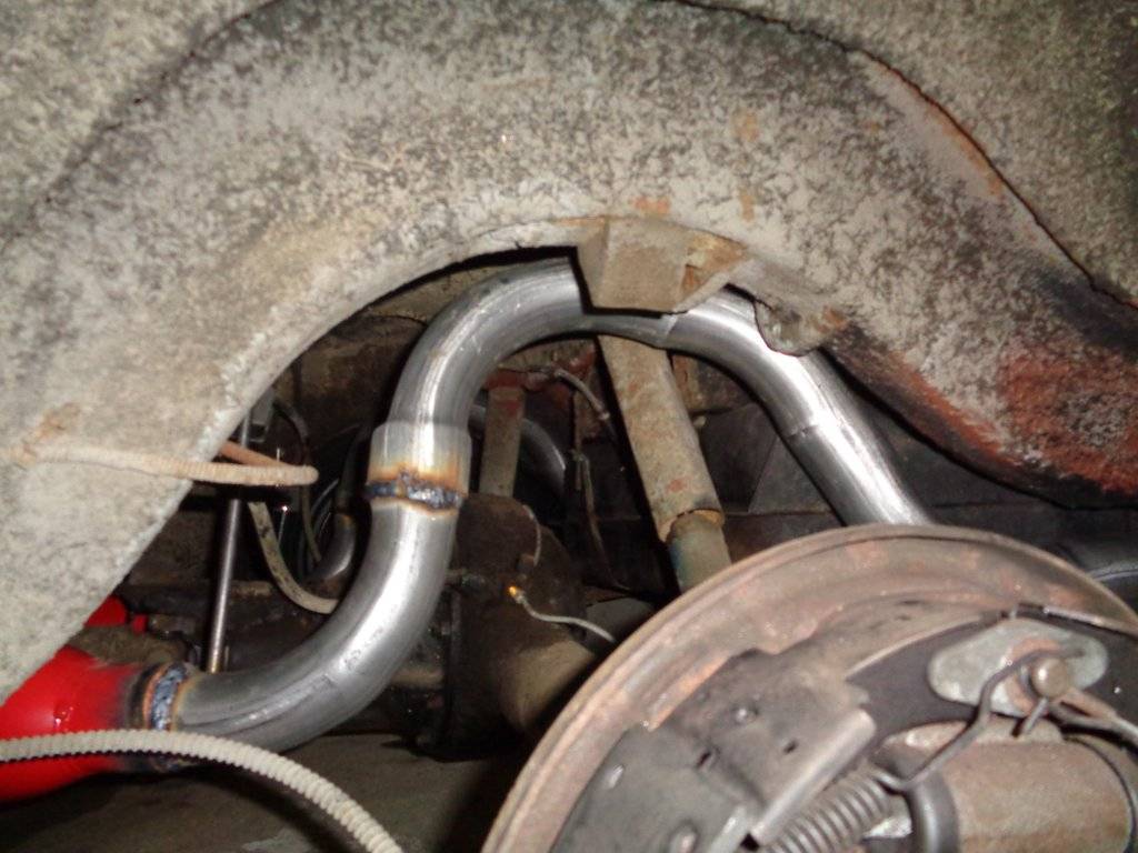

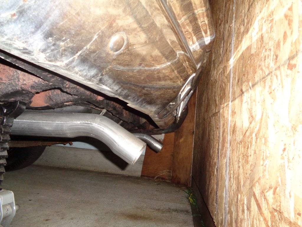

if the people at your exhaust shop have any skill, they won't need cards or anything else. they should have the flanges and gaskets. if you have an o.e. right side tailpipe on the car, they'll copy it in the size you want. for the left side, they copy it backwards. my '69 newport that i bent by sight in the early nineties.
changed the mufflers recently

Your system looks great (nice job!), but others may not have the skill or time to do it right.

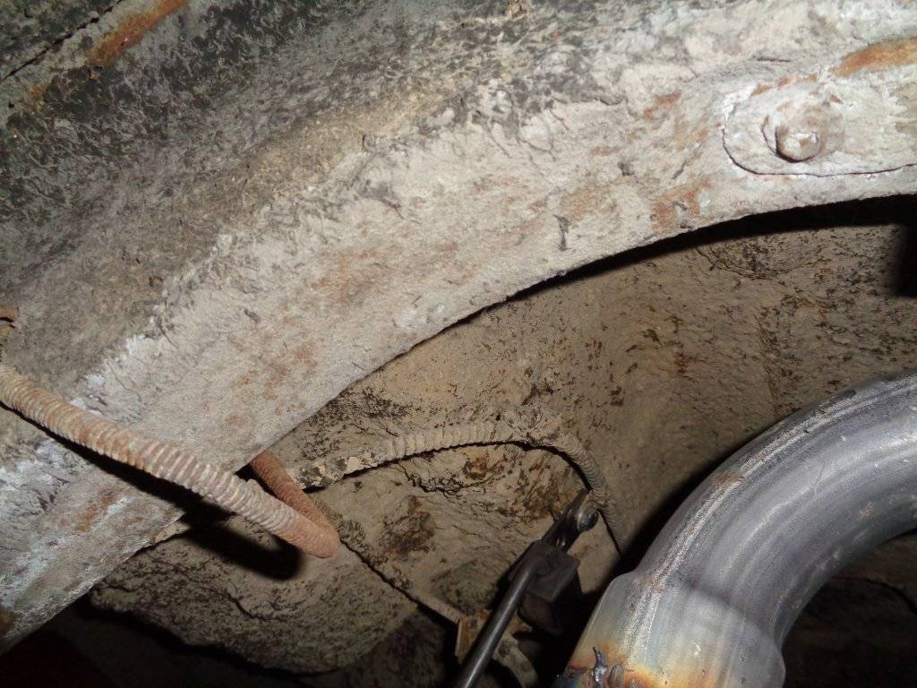

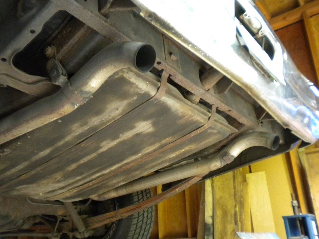

I hope my car has the spot for the pipe on both sides of the trans mount
It seems that my 67-300 does not have the radiused area for the pipe to pass(passenger side). What have people done in this case? I think Mother decided what will have duels and what will not before the cars were ever made.
Both my stub frames are radiussed on both sides... it would be fairly easy for a competant welder to mirror the recess you have on yours already...
Both side allow for exhaust pipes thankfully.
