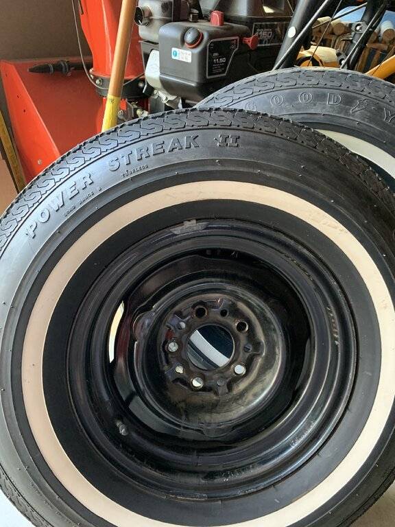

Are these old wheel/tires worth putting on the shelf and keeping? I’m getting ready to get new wheels and tires and one option would be to just put new rubber on these 14s. I figured there may be some collector value as these seem to pop up for sale occasionally. Anyhow I have 5 of these H78-14 with the spare and just figured I’d be getting 5 new wheels/tires in a 15 to 17 inch size for regular use. Do folks actually drive on these old tires just for shows?
They have an original appearing style white wall and Goodyear Tires did appear on some Mopars. If they have good tread and the casings are free from cracks, they probably are a display tire for a car show. I probably would not recommend trying to drive the car with those tires as they are very old. Can't tell from the photo is these were belted or not. The early Polyglass tires were famous for throwing chunks even when new. Upside H-78-14 tires are mostly not being reproduced, so you have a tire size that was probably original to the car if that was how it came from the factory. The biggest modern radials that are readily available at your local tire store are going to be P215-R14, which is small for a C-Body and you will get a lot of wheel flex which tends to throw hub caps on the factory 14 inch wheels.
Dave
As good as those tires might have been when new, they were not OEM-level tires. Chrysler and Goodyear obviously had a strong relationship for decades, just as GM had with UniRoyal and Ford with Firestone.
Due to the age of the tires (verifiable by the codes cast into the inner sidewall, they are probably well past their useable life. They would probably be good to use to roll cars around on, but NOT for street driving. It used to be that as long as the tire would reliably hold air, with some amount of tread on it, it was still "good". Or good enough to put on farm grain "drills", etc.
Of course, they would make good display items and reference items to compare to modern tires which might replace them.
14" wheel flex is real, evidenced by the two nubs on the outer edge of the 14" wheels, either side of the falve stem. With corresponding tangs on the wheel covers . . . which did NOT prevent the wheel covers from rotating on the wheel on our '66 Newport. Luckily, the valve stems didn't break, just flexed. I ended up removing the valve stem extensions and installing the wheel cover with the valve stem hole away from the valve stem itself. No similar problems with the 14x6.5" station wagon wheels I put on the '67 Newport or the 15x6" wheels on the '72 Newport Royal.
Enjoy!

I use old bias ply tires like that for winter storage to keep the good tires from getting flat spots and will use them for the odd trip I'll take around town to keep things lubed and moving freely.I wouldn't take them up to highway speeds or go very far with them.
I also like the vintage vibe they give when they're on the car.
