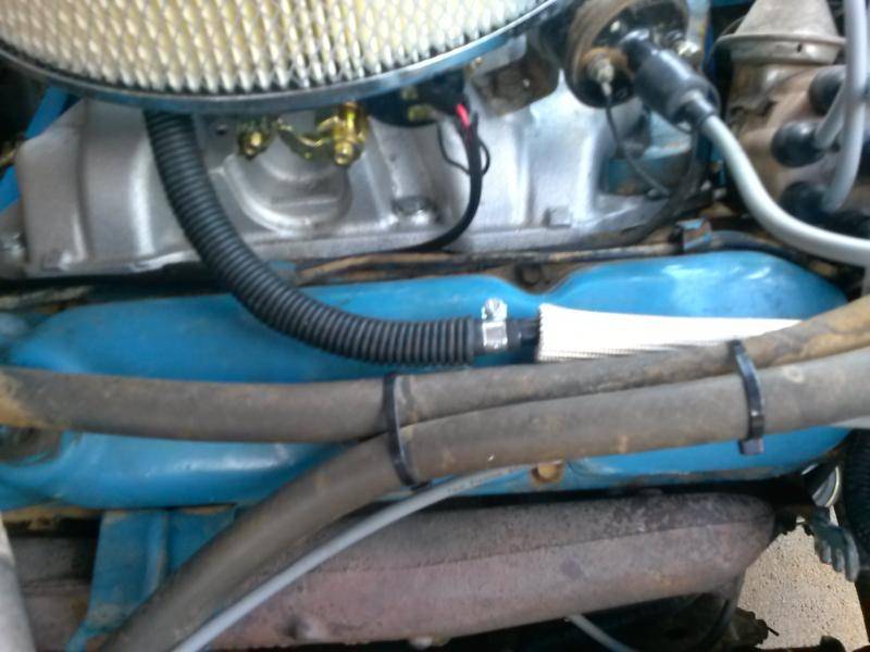

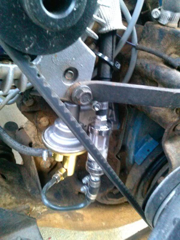

Yes, it cranks just fine. Just takes it a while to start again after its hot. Cold starts in less than 2 seconds. I think the gas is getting too hot. Couldn't fit a spacer between carb and intake due to the passing spring would be at a bad angle.
How is the fuel line routed from the pump to carb? Welcome and nice car!
From the fuel pump, to an inline fuel filter, then, its wrapped in some heat shield, goes right over the engine and into the carb.

hell ya nice ride. when the motor is warmed up, turn it off and remove the air cleaner. then pull the throttle cable. do you get a good squirt of gas into the carb throats?
Nice ride. Only thing I would do is get rid of the glass fuel filter. Not that I care about originality as some are, it's more of a safety thing. God.. Bob I don't believe i posted that.
