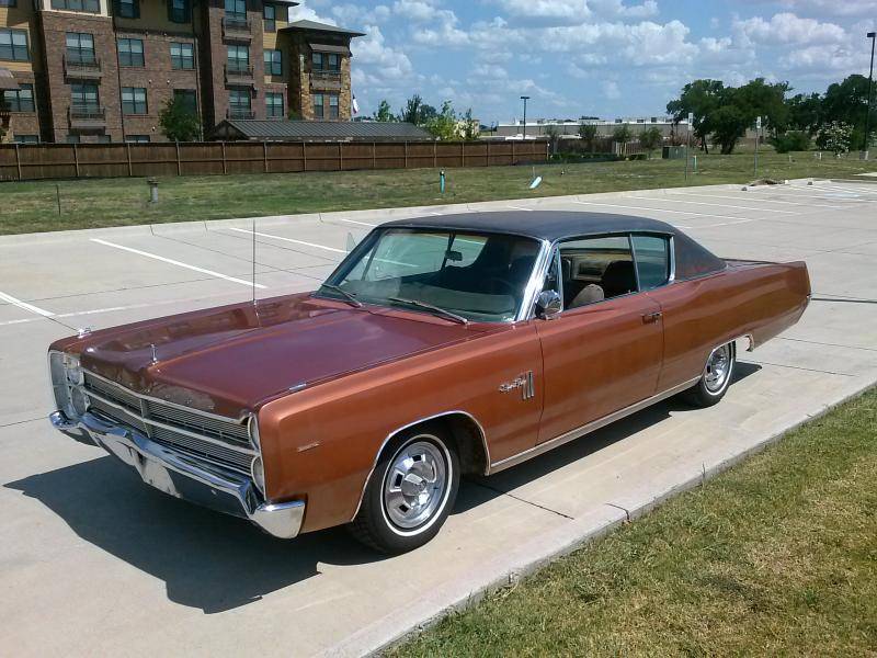

Got my first classic car - 67 Sport Fury

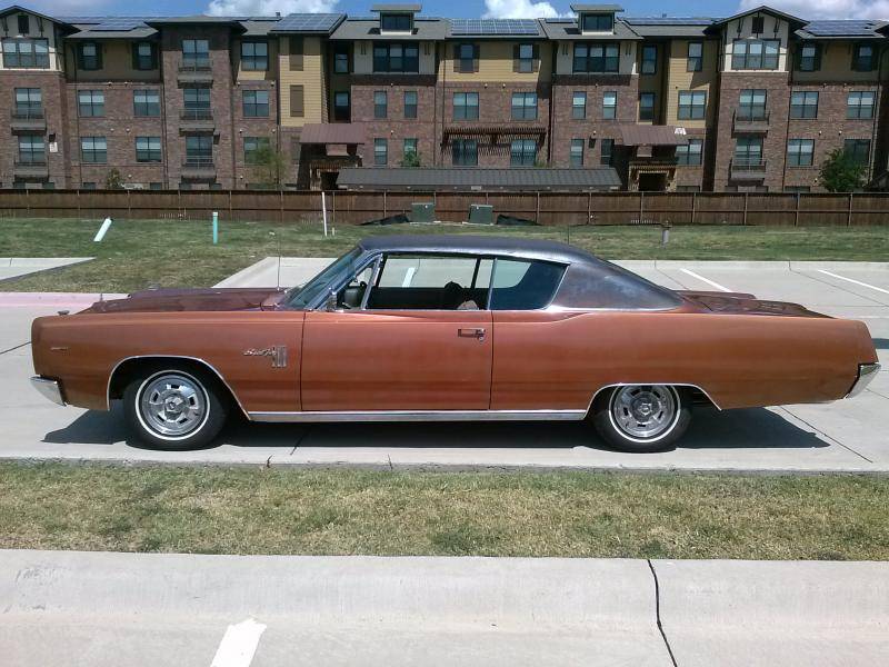

I saw it on Craigslist about two weeks before I bought it. I had originally been looking for a 67 Cougar XR7, but really hard to find in price range. I wanted to go check it out but it was a long drive and a bit more than I wanted to spend. I actually saw it on eBay, two weeks later, and the day before the auction ended. The seller removed the reserve and I got it for half what was asked on Craigslist. I though it was really awesome that I happened to come across it again so randomly again and knew I had to have it. I guess It's Destiny, That's what I named her. I'm glad I did. She runs fantastic now, sounds amazing, is in overall great shape. She sat for 22 years in Arizona, so very little rust below the rear window is it. Only about 23k original miles.
Just wanted to share more pictures.
Nice car!
welcome to the forum!
