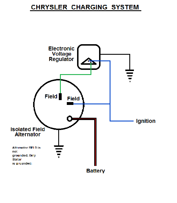

That sucks having to go through that many alternators and regulators. Looking at the gauge in your video, I think it's probably not the diodes. That appears to be a slow, intermittent pulse. Any alternators that I've seen with bad diodes have produced a rapid, continuous pulse. You said you connected your regulator to the "remote wire" at the ballast resistor. I'm not questioning your skills, but are you absolutely sure that the VR is connected to the 12 volt terminal of the ballast and not the coil side? The VR needs the full voltage. Do you have the single or dual ballast resistor?
I notice that you've grounded the VR and the alternator is grounded by it's mount. Are your battery terminals good and clean, making good contact? If all of that checks out then maybe something else in the car's wiring is causing it. I hope you find the problem soon.

That is correct. It was connected to the ignition side of the ballast wire. I was only using it as a switch because I'm not using the ballast at all(msd).
