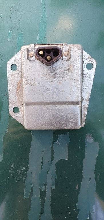

May I see a pic of the voltage regulator you are using? Thanks!
Well I said a while but I didn't plan on almost a month and a half... Don't know if you still need it but I pulled it out to get you a close up pic. The numbers read 1601 12V and those are the only markings on it. Don't even know if it's original to the car but this is what I've got.
