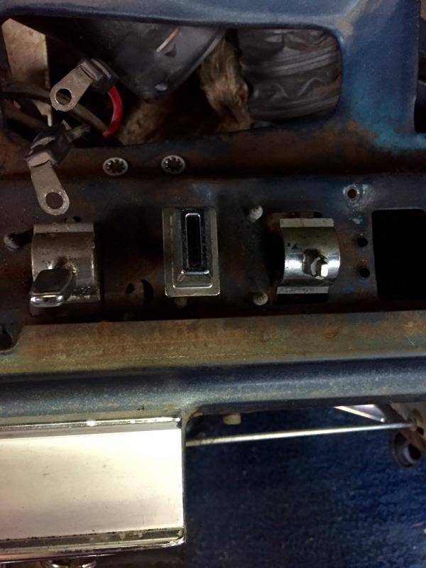

Well last year my hazard switch broke in my 67 fury 3. I got another switch out of a Newport. Now I'm pulling by hair out trying to figure out how to get the old one out. It a safe assumption that they built the dad out of the car and from the back!! So how in all that is holy are you supposed to service the switches? Any help would be appreciated!!
It's not so bad. Take out the ash tray, and ashtray tray. Once those are out you can look straight up and you'll see the 2 Phillips head screws. Take em out. As the books say installation is reverse of removal.
Well that figures!! It's gonna have to wait then. I tried getting the ashtray bracket(for lack of a better word) out but wasn't cooperating and I didn't want to force it. Check out my next post see why it will have to wait. Thanks tho!
