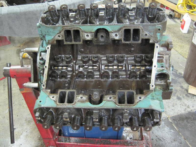

I got all these new items for my engine and suspension this week, but won't be touching any of it for a couple of weekends. Instead I spent all afternoon degreasing the engine. I am glad that is done. What a nasty job.

Ask Gary how to keep it clean next time so you don't have to do that again. ;)

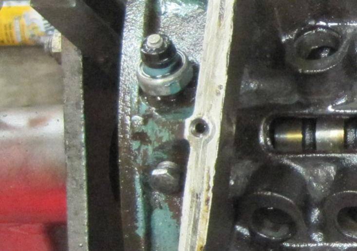

Yes it is, does it seem odd to you? I got a set of freeze plugs and there where at least 4 bolts in the packet.
Pipe plug for another example of strange external plumbing???
Well, as long as it's not a bolt and it has an NPT Thread.....
But I still think it's a machine bolt jammed in there.
Mike, take it out and put my mind at ease.
So I understand this should be a tapered bolt not a straight machine bolt. Since I have a new set of freeze plugs, there should be a tapered bolt to fit that place, from the set?
Yes. They are usually a countersunk Allen or have a 4 pt. head. And yes, an NPT (National PIPE Thread) is tapered.
Maybe the one on Mike's block is a hex head plug. I hope so. If not, the threads are ruined.
No, they don't include an extra plug for that one, Mike.
If that's an NPT Hex plug, you're fine. If not, you're going to have to retap it with the next NPT size up.
And please stop calling it a BOLT. LMFAO.
It's a PLUG. :D
It is plug and not a bolt. It is plug and not a bolt. It is plug and not a bolt. It is plug and not a bolt. It is plug and not a bolt. It is plug and not a bolt. It is plug and not a bolt. It is plug and not a bolt. It is plug and not a bolt. It is plug and not a bolt. It is plug and not a bolt. It is plug and not a bolt. It is plug and not a bolt. It is plug and not a bolt. It is plug and not a bolt. It is plug and not a bolt. It is plug and not a bolt.....................................................................................:laughing4:

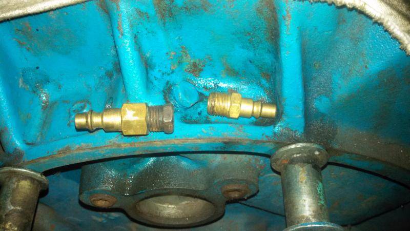

Here's a shot of a 70 440 with said plug and another one threaded into 1/4 npt air fittingIMG_20140202_132940_716.jpg

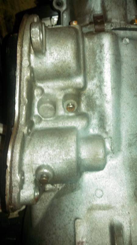

They also used 1/8 plugs of same style for pressure ports on transIMG_20140202_133239_112.jpg

I took the plug out and it is a hex headed plug. They were that style at every location on my block. My new plugs are the other style with the allen wrench head.
I have had problems getting the Allen wrench plugs out in the interior oil galleys the one behind the timing chain but maybe the guy was a gorrilla or mad at work that day.:dontknow:
