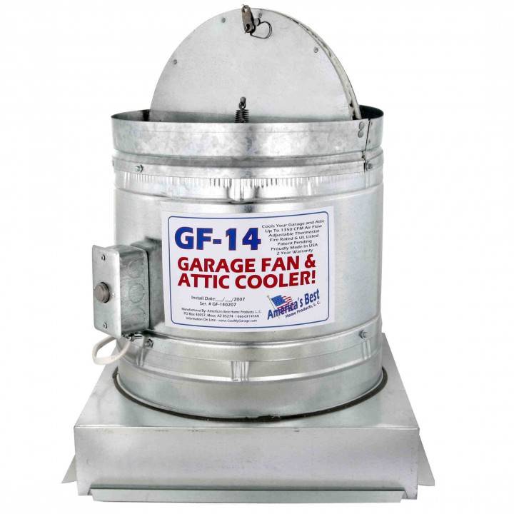

Has anyone installed a garage attic fan?

Ross, this attic fan is supposed to force hot air out of the attic through the vents. The house and attached garage has ridge vents and soffit vents. There is also one vent on the top front of the garage. Do you think the extra vent on the front of the garage is messing with the flow of the air out of the attic?
I've also been reading up and watching some video on gable vents and the attic vent company suggests that it would be good to use a fan on the gable vent opening to work in tandem with the garage / attic fan.
But I'm wondering if it's a bad idea to have a gable vent at all with a ridge vent at the same time .. the other roofer told me when we were having my mothers houses re-roofed last summer that it's an either or. Meaning to always use soffit vents, but only use ridge vents OR gable vents not both as that would cancel out the air flow or something.
I took a break and I've just been up looking at the garage / first floor attic and the gable vent is decorative as it's got plyboard over it so it can't be seen from inside the attic. Would it be good to open it up and put a thermostatically controlled fan on it to suck the air coming in from the garage fan out? Or BAD idea considering I have ridge vents?

The decorative gable vent (boarded from inside) is approx 2' in diameter so i could open it up and put a thermostatically controlled fan on it. It faces West though.
edit .. Looks like Ross confirmed what the other roofer said .. don't mix gable and ridge vents. Since I have ridge vents I'll leave the gable vent boarded shut.
You can't mix roof mounted power vents with any other type of roof vent, it has to be one or the other.

so unless you say otherwise I'm thinking of just using the garage ceiling mounted attic fan which should force air out the ridge vents. (misspoke earlier when I said soffit vents too ... I'm assuming that's not going to happen).
Any more warnings or suggestions Ross? Or thumbs up on the plans?
Thumbs up. No gable vents.

do you only have ridge vents at the top for the exit air ?
no whirlybirds or anything?
I think if you 'pressurize' the air going into the attic by a motorized input fan (your attic fan) you need to be sure you have enough exit volume up top or its gonna try to go out the soffit vents and mess up your flow.
I redid my roof and insulation last summer, have 5 whirlybirds up top, and added 2 layers of insulation on top of the R-nothing crap the builder put in, one layer runs long, then on top of that another layer running the other direction. huge difference. no attic fans though...
but the whirlybirds are supposed to pull air through the soffit vents... not sure what a fan is going to do to your air flow
