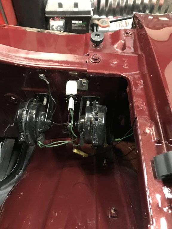

Does anyone have pictures of how the horns are wired up? I need pictures of that side of the engine bay and head light area please. Please send to fdinatally@gmail.com Thank you in advance for any help you can give

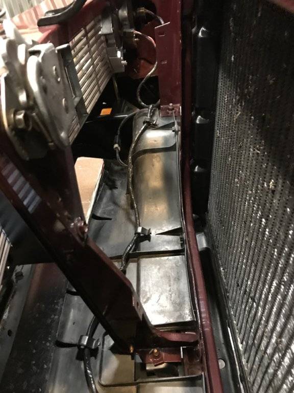

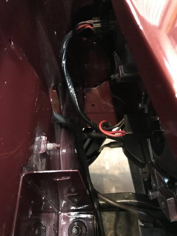

From horn mount right front to light harness right front.
HWYCRZR Thank you very much!!! Those pictures are perfect for what I need to do.... next issue will be headlights not working But thank you again
