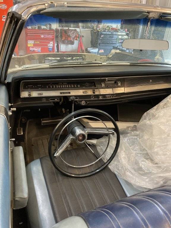

I don't know. I tried to unscrew the center cap on the steering wheel, but it wouldn't turn. I thought it would just unscrew. I gave up when it didn't because I didn't want to break anything. Below is a photo of the steering wheel. How do I get the center off?
Regardless, I don't think I have the rag joint on my steering wheel assembly. Maybe someone can look at this photo and tell me for sure.
You have the same steering connector as 68 so no rag joint. Question. Is your steering column secured to your dash? If not you may try running a jumper wire from the metal column to a good ground. If the ground wire with the eyelet is not connected tightly to your steering column bolt you will want to connect it or use a jumper. The horn switch grounds through the steering column. If it doesn’t have a good ground, the horn will not compete the circuit.
The center cap takes about a quarter turn lefty loosy to take off. It is metal on metal tabs. So if it hasn’t been off it might be difficult to get started.
