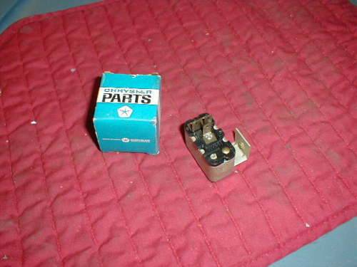

The Headlamp Warning Buzzer started in the 1969 model year. If you want to use original parts, look for a car that has the option code A01 on the data tag.
Hear is what the actual buzzer looks like.
