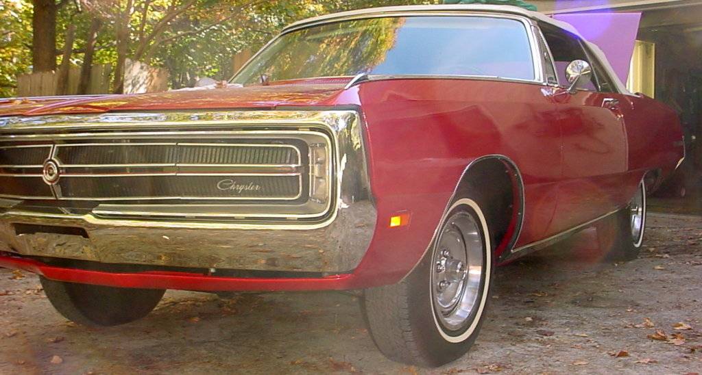

Here is a good picture of the surround for comparison of your '70 on Will's '69

70 is very different.
Yes I started comparing them and realized they are different. It does seem the bumpers are exactly the same in '69 and '70. Does anyone know this for certain?

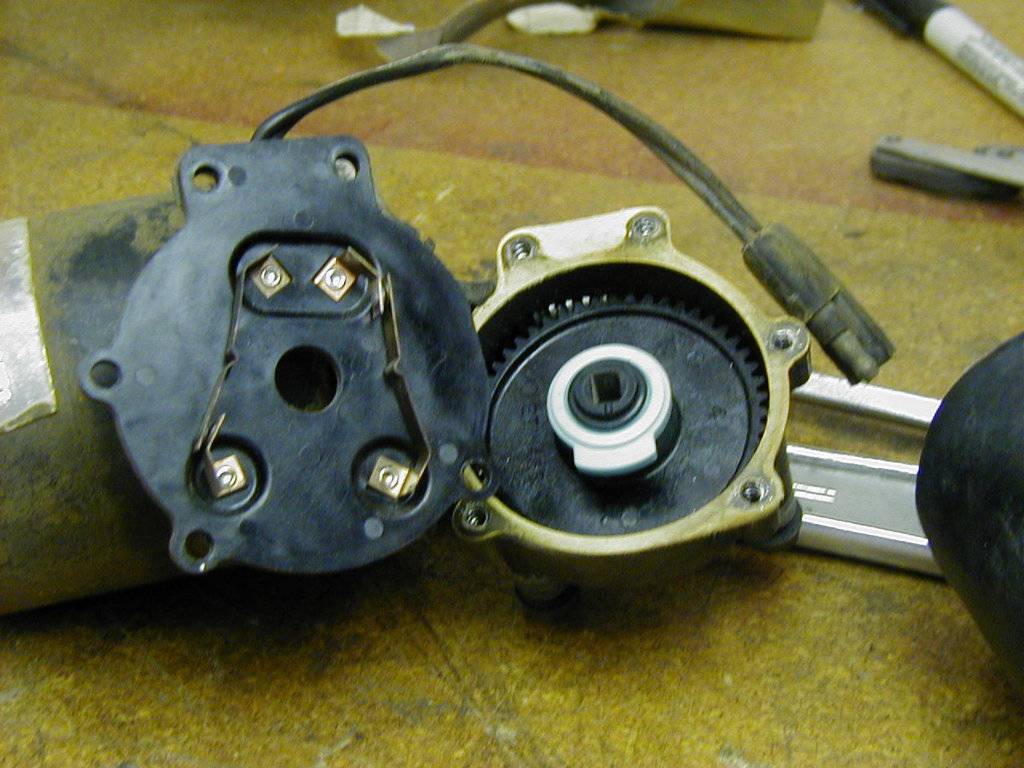

The motor's have a plastic limit switch which will easily break if you power up an uninstalled motor. Virtually all "failed" motors have a broken limit switch which can bed replaced. I've seen them of eBay from time to time. Note the color of the switch assembly is important.
Red - Plymouth's and Charger's
Black or Green - Dodge Monaco
White - Imperial's
Couple of motor with the switches exposed
Front bumpers are the same, ‘69-‘70. Rears are different.
I remember reading that in my 70 FSM and then I was looking at a 71(?) manual and it said that you could check it out of the car.
After seeing your post, I think the difference is the style of contacts. The later style (bottom pic) can be powered up. I did it with mine with no ill effects after reading in the FSM.... What I didn't know until now was there were two styles. Now it makes sense. My car has a later motor in it.
I have powered up all of mine albeit short bursts and it has been fine
