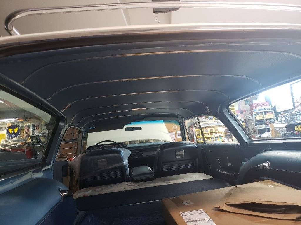

REM Automotive, INC Fit perfect on my 64.
