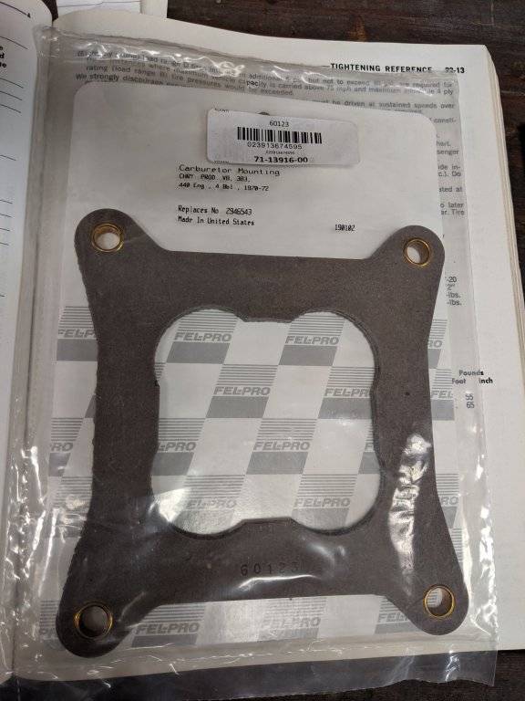

I used this Felpro 60123 on my 1970 440 factory intake with AVS2. Good results, no vapor lock, etc. .25" thick, I believe
