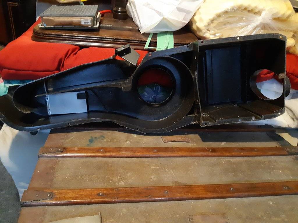

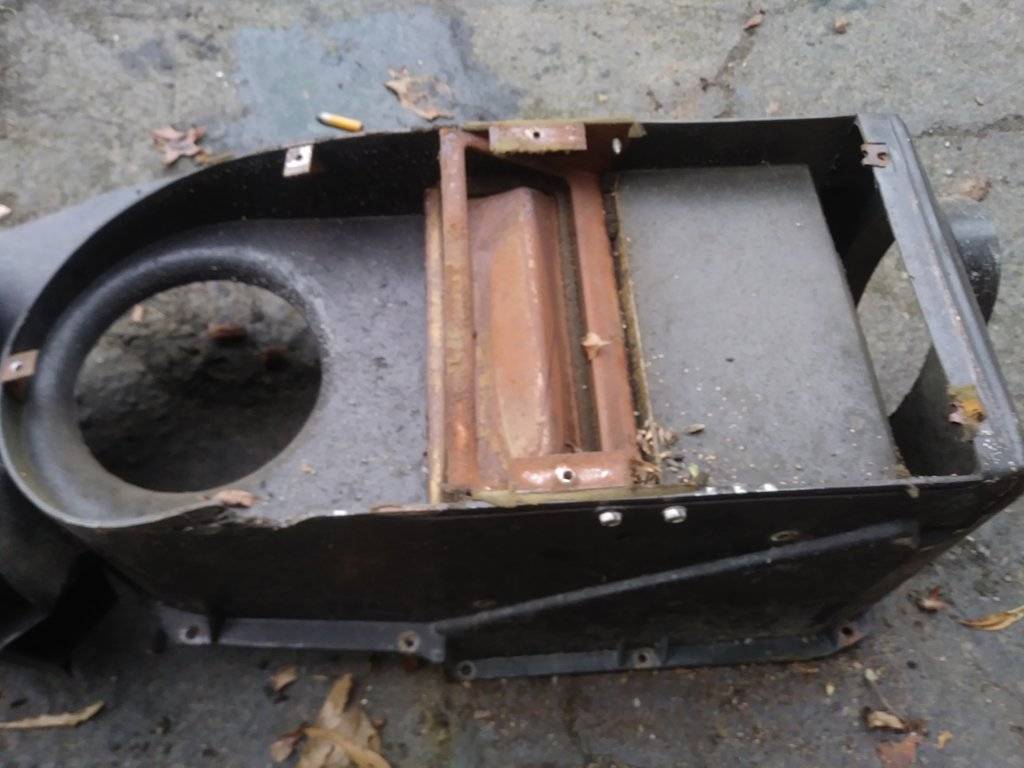

Just cleaning up fr heater box and looking for pics/posts on how all the foam seals are installed around the doors. This is the non auto air unit from a 67ish monaco.
I realize there are kits for this but hoping to just use what I have here but the manuals are not helpful in this regard. Stuff was loose and seemed out of places looking to get it right.

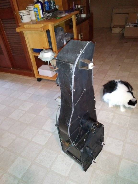

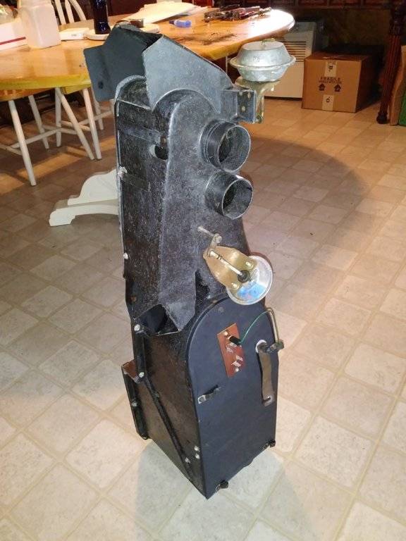

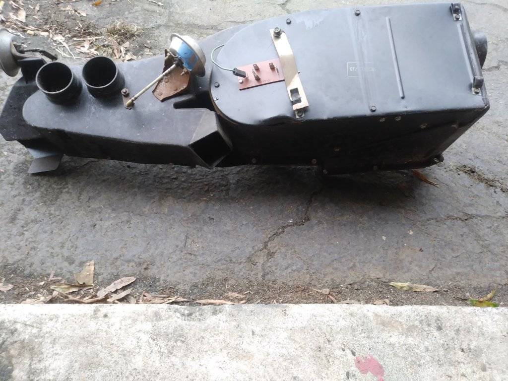

I just recently reassembled the heater box from my 67 Polara using foam sealer tape from ACE hwd. I don't have pictures but it isn't hard to figure out what needs to get sealed.
MCT has seal kits for these.
I got the kit from detroit muscle...great kit and very good instructions. cheap too. Your heater looks exactly like my 67 newport heater. I can try to explain where things go if you like...
Thanks for the pics and info. I need fender seals so will just order the kit for heater as well. Inner doors and flaps had a good layer of rust thanks to mice piss so are soaking now in vinegar.
