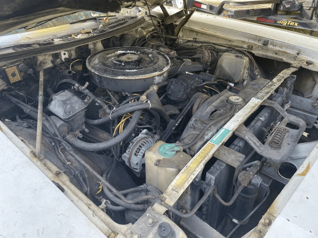

Oct 1, 2023 #1 hacksaw71 New Member Joined Sep 30, 2023 Messages 21 Reaction score 14 Location hopewell PA the black box on the inner fender. im guessing its for the heater and don't work cause its bypassed. what is it and what dose it do??
Oct 1, 2023 #2 Mr C Senior Member Joined Nov 20, 2012 Messages 4,706 Reaction score 4,766 Location Winnipeg MB, Canada That is the Autotemp servo/ coolant valve. The original plastic ones often cracked and leaked...Mercedes used the same system and the new pricey re-pops are aluminum and solve most issues.
