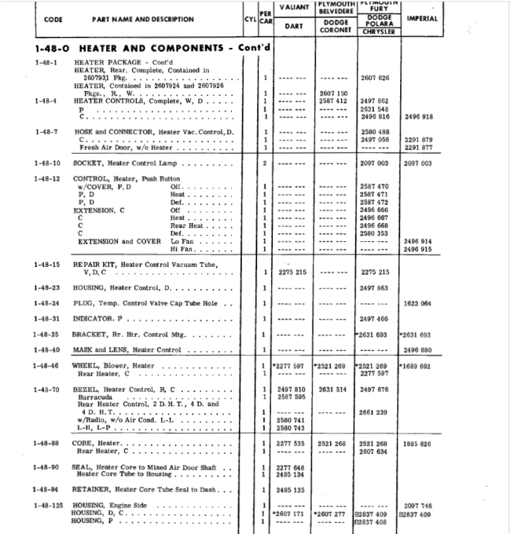

I'm looking to see if these heater boxes are interchangeable ? I have a 67 Fury non A/C and my heater box is model 712, I have the chance to purchase a non a/c heater box from a 66 Fury heater box 735. I'm wondering what the differences are and will it bolt into my car. My thought process was to rebuild the 735 box and be able to just swap the boxes to lessen the down time as my garage is not big enough to work in so I have to do this work outside. As far as I can find out the heater cores look to be the same, the gasket kit looks to be the same. Blower motors don't look to be the same as best as I can tell. But I can't find anything about the actual heater boxes themselves.
Any help would be greatly appreciated. Thanks Pete.
If you go to mymopar.com you can download the parts catalogs. Then look up and compare the part numbers. You can then decipher which parts are the same. The actual box would be the determining factor as the attaching parts can be changed to what fits your car.

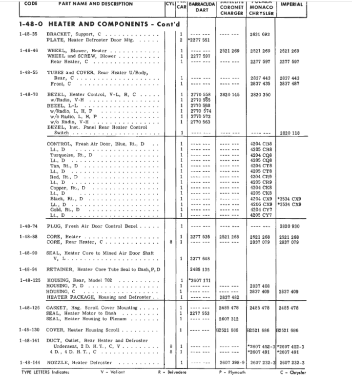

I looked in the '66 and '67 parts catalog. I'd say the housings are the same. #2837408
sec 1-48-125
1966
1967
