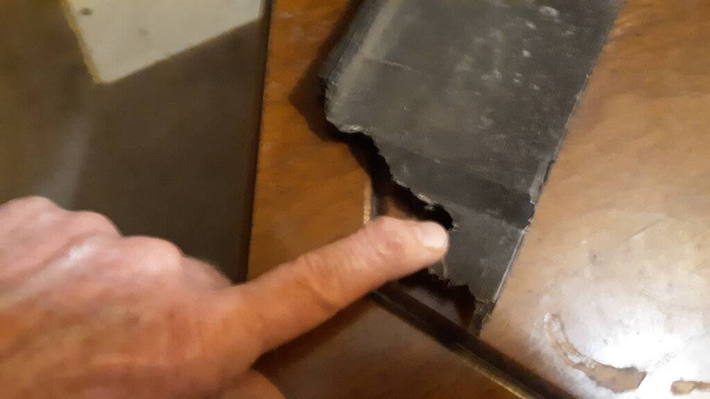

I have done these a couple of times. To answer your questions, yes you must remove the glove box. The center and right ducts need removed. If you have a center console remove it. Remove the floor duct. With these removed, remove the pass. seat and pulling back on the carpet greatly aids in heater box removal. When removing the heater box, use great care in removing nuts at the firewall as they are notorious for seizing up and breaking the heater box. See photos below. If seized up, try penetrating oil. If that doesn't work, split the nut W/ a Dremel tool and crack the nut.
