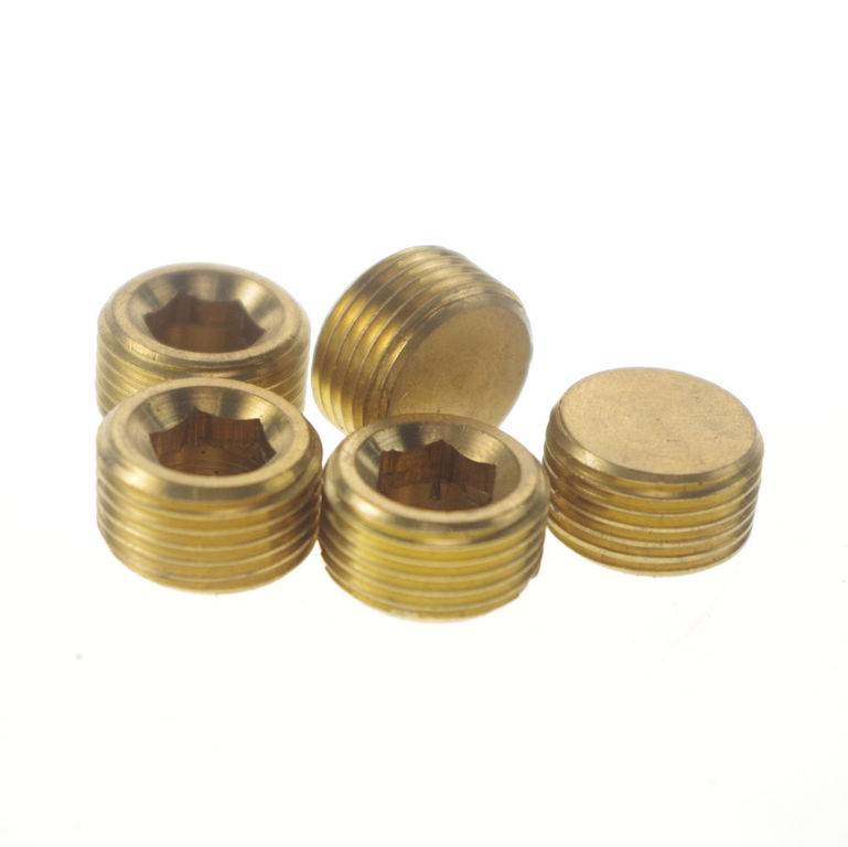

I removed the nipples form the block and used these to plug;
https://www.amazon.com/gp/product/B0743986K1/ref=ox_sc_saved_title_8?smid=A2AWTGDHMLIJ14&psc=1
Where the heater hoses enter the engine? I didn’t know it’s threaded there.
Yep. The nipples the heater hose hooks to should have slots on the top to help unscrew. They can be a real *****. A proper size washer can fit across the slots and leave enough room for water pump pliers to grab, or a closed Crescent wrench.
I just figure on destroying them with vice grips when I take them out. New ones are available for a reasonable price.
They are 3/8 NPT pipe thread, as shown above, if you want to plug the holes.
