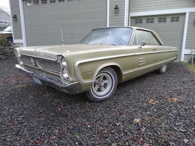

I recently picked up a 1966 Sport Fury so naturally the first thing to do (after admiring the car some) is to get on the net and search for others with a similar disability as mine (people who think large old Mopars are cool).
I found this site and another one (the "dock", as I'm sure a lot of you know about). Lots of neat rides on both sites.
Anyway, now to the important details you may be waiting for:
383-4bbl
4-speed trans
Manual brakes & steering
The car is pretty much stock from the factory except for vintage Superior mags and recovered seats.
I was able to track down and talk to the original owner (found his name on the Certicard, then did some internet sleuthing). He was in the Navy in '66 and walked into the local Plymouth dealer in Tennessee and traded in his Austin Healey 3000 on this Sport Fury that was sitting on the lot. He moved around a lot and ended up in Washington State, where he sold it to a friend before retiring to FL.
The car runs and drives (I was able to drive it 80 miles home the night I bought it) but it obviously needs work, as it had been sitting for 20+ years and has 150k on the odometer. I plan on just fixing the car up enough to get everything working and maybe cover it in a nicer color paint. Neither my wife nor I are big fans of Citron Gold...

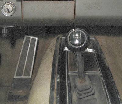

Welcome to the site from the Motor City! Wow, a 4 speed Sport Fury! Prepare to be envied! With a console no less!!!

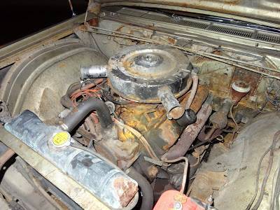

Welcome aboard. She's a beauty and is one rare ride with the 4 spd. With that high mileage the 383 may need a compression and leak down test. Good move keeping the little woman happy with the colour as long as you car have your way with what's under the hood.

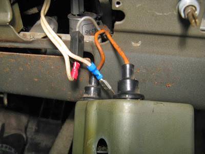

I've been working on small things on the car the last couple days (saving the brake overhaul for this weekend maybe - I can hardly wait). I took out the electro-mechanical clock and had to disassemble and oil it before it would run with any regularity. I added a toggle switch for the power so it wouldn't needlessly tick away while the car is parked. The photo just shows the extra wiring for the switch. I failed to get photos of the disassembled clock...

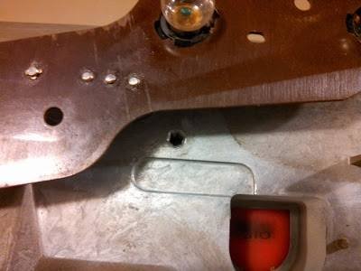

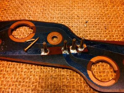

I also had to fix the four pins on the speedometer printed wiring board. Two of them were broken off and the remaining two were loose, so my dash lighting and oil/high beam indicators were hit and miss. I found some small brads that fit inside the hollow pins and soldered everything together. I also had to file down the heads of the brads so they didn't contact (as in short out - I found out the hard way) the speedometer housing. The brad heads were thin but obviously not thin enough...
