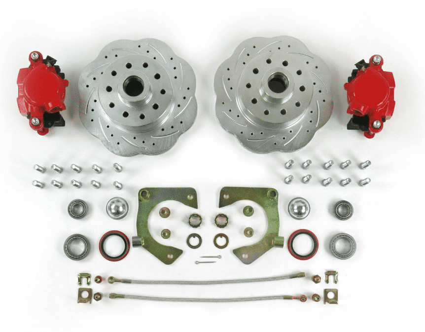

Would the Mustang front disc brake conversion kit be worth trying? I would like to keep my 14" wheels. Anyone with experience with this disc brake kit off Ebay?

Haven't heard of the Mustang front disc conversion before. Can you post a link to the info?

Where does it say in their website that this is a suitable swap for a C body Mopar? The C body is way heavier than the Mustang II, and their eBay ad clearly says that it's to improve those cars, but of course when you go on the "does this fit my car" list, you can see Plymouth Fury. Personally, I would be wary of such a retrofit, but perhaps it's OK.
Regardless, as noted above, I'd look into what is causing the judder in your car first. You may just need to cut the drum and the problem will go away.

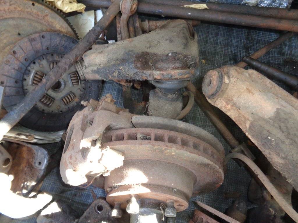

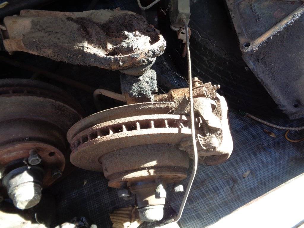

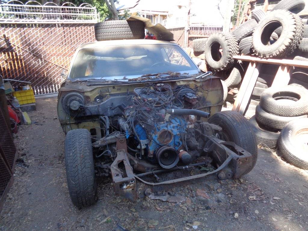

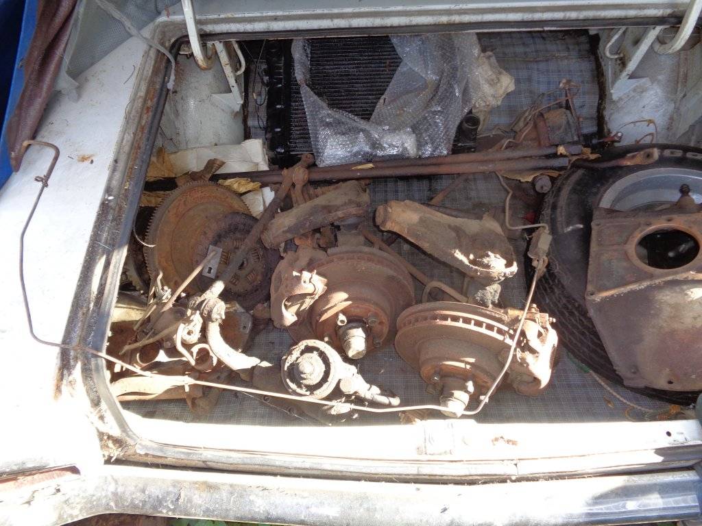

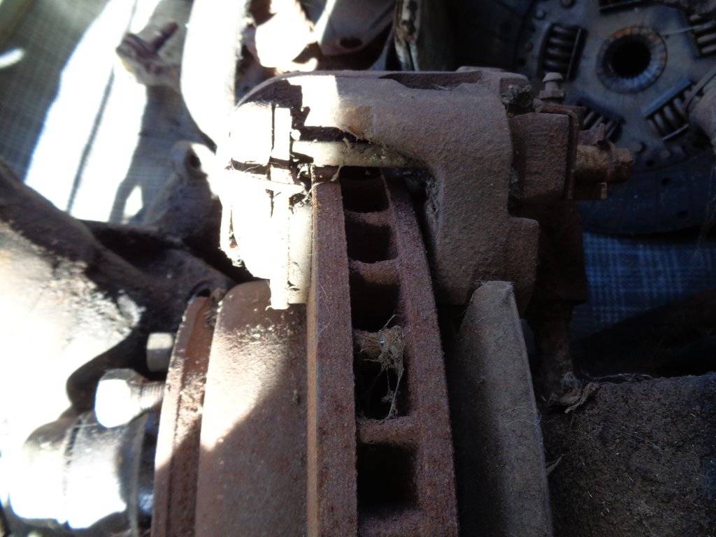

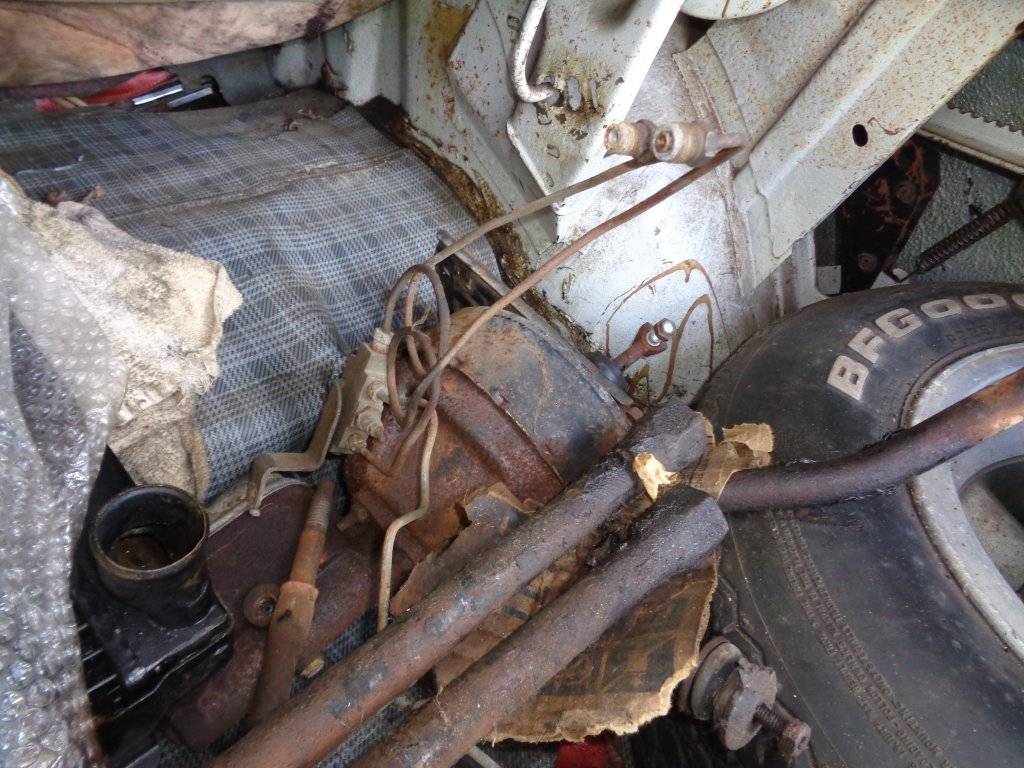

i've been grabbing the front brake disc packages from the 70-72 c bodies , single piston calipers , spindles , brake lines , master cylinder the works . works with 14'' or bigger rims . this one was a 72 fury 3 no one wanted , so it became parts for me and all here . and so did this 70 nyr more door .

I am wondering why in the world anyone would make flower-shaped rotors???
It would seem like you'd get strange pad wear due to the non-existent part of the rotor constantly going thru between the pads.
Or you mount the pad closer to the ID so that it sweeps fully on the rotor, in which case those lobes of extra material do nothing except add thermal mass.
Am I missing somethign???

Disc brake components are matched to weight of car
1. A body’s …dinky brakes
2. B and e …are bigger
3. C body and imperial biggest
Sounds like common sense.this is fact.
Going to speake out….
There are several distributors that sell MOPAR disc brake kits using the KH 4 piston caliper..aluminum copies
Facts.
1.were only used on 65,66 mustang they immediately changed design 67….not good enough
2. 65to 72 a body
2. Never used again…use dinky thin rotor
And caliper is one of the least powerful of all time
3. Many videos on this
Mass of rotor directly proportional to power of brakes
Rotors convert kinetic energy to thermal.
Heavier rotor more heat absorbed before fade.
That’s why rotors match size of car.
That’s fact. This above is unheard of
As I think about this more, the heat gradient increases toward the OD of the rotor, as it has increasing linear velocity moving toward the OD.
So with even pressure on the pad, there is more heat generated toward the OD, and more of those trapped gases the experts talk about (which is what drilling/slotting is to solve).
So the lobes of the rotor allow those gasses to really escape, and the geometry of the lobe cutout is (presumably) made to match that gradient.
But I still think, if it was such a great idea, somebody would've introduced it long before now (unless F1, LeMans, etc, have already used this idea?).

But there are 2 other factors involved in the evolution of these brakes:
Cars were getting heavier, even within the same model of car, which doesn't mean those prior brakes weren't good enough for prior cars.
Cost-cutting - single-piston calipers were much cheaper to make, and cheaper/simpler to service.
Many modern cars use multi-piston front calipers because mfg cost/efficiency is light-years better than in 1965-1968. (and so is braking performance, albeit for other reasons also).
The OP wants to retain his 14" wheels, so likely his tires would become the limiting factor in braking (if he converted to an aftermarket 4-piston with 11" rotor).
