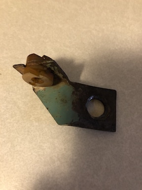

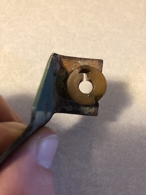

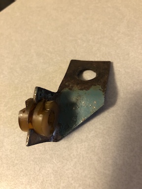

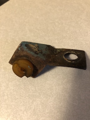

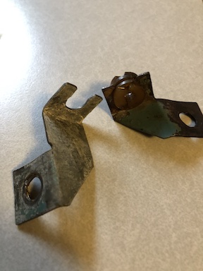

So i had some very unorganized help removing my 383 and 727 from my 71 newport custom and these brackets turned up. I didn't take them off so I don't know where they go back on. There's two of them and one seems to be missing the plastic insert. Any help would be greatly appreciated!
They go on the exhaust manifold studs at the rear of engine.
They do? I believe you're quite right.

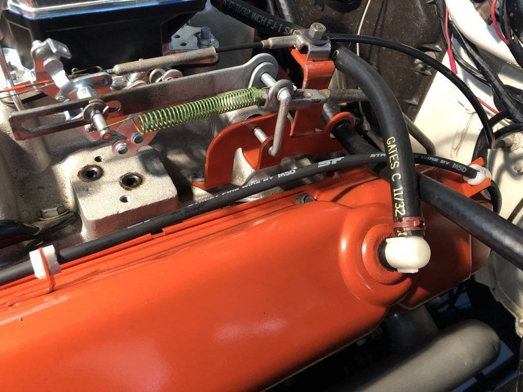

This is from the Hoffman's website: Hoffman's Winners Circle Ignition Wire Brackets
In my own case, since I had headers on the 440 I had some routing issues that were much different than with OEM manifolds so I did use these brackets on the rears of both heads. I also made my own valve cover brackets, using the same brackets and modifying to make for an "OEM-ish" routing and look. JB Welded into place....came out nice, and far from the header heat.
