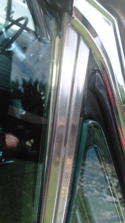

I decided to reopen my own thread because one of the issues appears to be the seals that the slider goes through. I haven't been able to locate a source for these although I may write AMS and see if they have a couple. The FSM is pretty clear on what is needed
Here's a couple photos of the pieces. They are thin pieces of gray plastic(?) and are deteriorating. I have found rubber and flocked rubber inserts for the vent gutters....not sure if these pieces would've gone into them, or they are stand alone.

It looks like you need the new channel guides for the front window.
These kits aren't cheap by any means and if you screw it up when installing it, then you're out more money...so be careful to do it right the first time :lol:

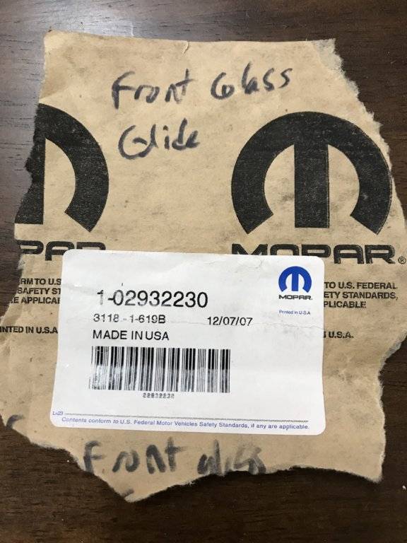

Ok, but I haven't found a source. Got any ideas?
The local Chrysler dealer could still get them about 8 years ago. (date on package was 2007) They were used for years. It is worth a shot. I have the new P/N somewhere in a thread that Will had going.
67 Polara 500 convertible
The P/N is about 3 posts after this one. Edit ( I grabbed the picture)

Glad to help. the flocking is gone from yours... likely many years ago that it rubbed all off.
I sprayed my replacements with silicon spray to make life easier for rolling up & down.
Mine looked the same way after many years. No flocking, and a dull grey colour to the plastic (what remained). The one difference I can see is that the alignment nubs that go on the glass were black. New ones are white.
. You will find that they may be slightly bigger than the old ones and will be very tight in the channel. I had to file a bit off to get them to operate as they should.
