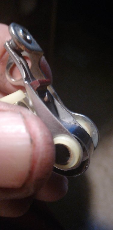

well she is fixed a i turned out the timng was good but the rubbings block on the points they put in it was JUNK ! i told him not to use them afTer llm i had 10 complete Sets of mopar NOS ONES HERE( BUT RICH INSITEd WE USE THE ONES TEY HAD IN IT , IF HE HAD DONE AS I HAD ASKED HIN TO USE I DONT THNK I WOULD HAD ALL THE HEADAKES. )IT THE POINTS ON THE LOBE WAS ALLMOST CLOSED & ONE side of the contract was allmost gone! but it starts runs right & now I;M HURTING REALLY BAD'
the points was junk
