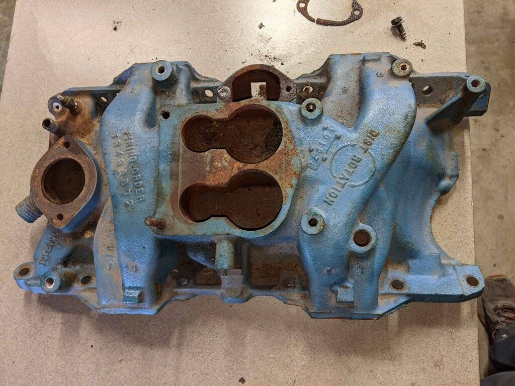

It looks like the primary bores in a factory spread bore intake have a much wider separation than the Demon. Would you use this on a factory intake or would the narrow gap between the bores and the gasket/adapter required to compensate mess up the vacuum signal and rob the carb of some of it's crisp throttle response? Thanks, Ben
To use that carb, or anything besides a spread bore carb on that manifold, you'll need an adapter.
Per the Holley site "This model of carburetor has the square bore flange bolt pattern. It can replace Holley, Edelbrock, Carter AFB, and Autolite style carburetors with 5 3/16" x 5 5/8" bolt pattern. If you have a spreadbore style intake manifold, you will need an adapter to install this carburetor. Similar to the Mr. Gasket #1932."
IMHO, any performance gains from the carb with that manifold with an adapter are going to be negligible at best, probably negative.
I agree 100% Time to sell that 3512100 manifold to someone who is building a 71 340 for stock restoration. Maybe on FEBO. I'm having it cleaned up at NAPA. Maybe I can get some good money for it.
