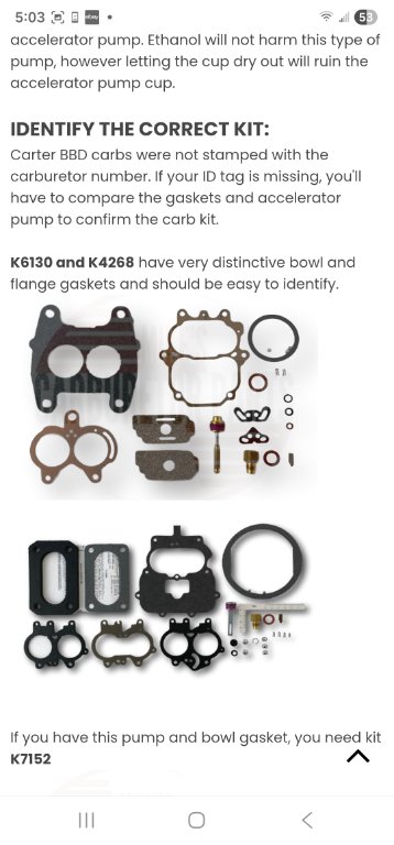

I had a minute at home finally and dug out my 70 polara carb and intake and the first thing that struck me was this is not a holley carb at all.. it's a Carter product. I knew it was the same as the Newp which I checked and confirmed. The story ends where it should have started with me checking the FSM. Of course I was not at home where all of these things are when I was trying to identify parts to order..
The FSM gives two variations for 69 which didn't match the tag numbers.. however the Mike's carburetor site has library on identification. Apparently this carb existed in some form on some product from atleast 1952 to 1990. That's a great run when you consider the advancement in vehicles.
Anyhow sorry for the waste of time but the lesson gained is, the model info is not stamped on the carb at all but is instead on the id tag held on by a bowl screw which could have been switched up.
The recommendation from Mike's is to take it apart and confirm.
Iw ill do this with my dodge unit and order gaskets and a accelerator pump at minimum.

Carter BBD, 2 Barrel Carburetor Kits w/ Free Carburetor Manual
Thanks for that information. The Carter BBD had two sizes. The "LA" motor/"318" size and the "B" motor size, with 1.56" throttle bores. The "Carter BBD 1.5" has a larger and more rounded float bowl section. The smaller "318" size has a more curved/angular float bowl section that is smaller. These nuances can be seen in the FSM pictures. The "318 size" BBD also has 1.44" throttle bores.
It was replaced in the 1970 model year with the Holley 2210 family carburetors. With the Holley 2245 2bbl in '73, with the addition of EGR to the carb and intake. Both of these carbs look the same, with the 2245 having a few more vac line nipples on the carb baseplate.
Glad you got the carb ID figured out. It would not surprise me if the basic gasket kit was the same from about '65 to '69, or possibly earlier. The main differences would be fuel calibrations, I suspect, plus how the air cleaner attached to the carb top.
