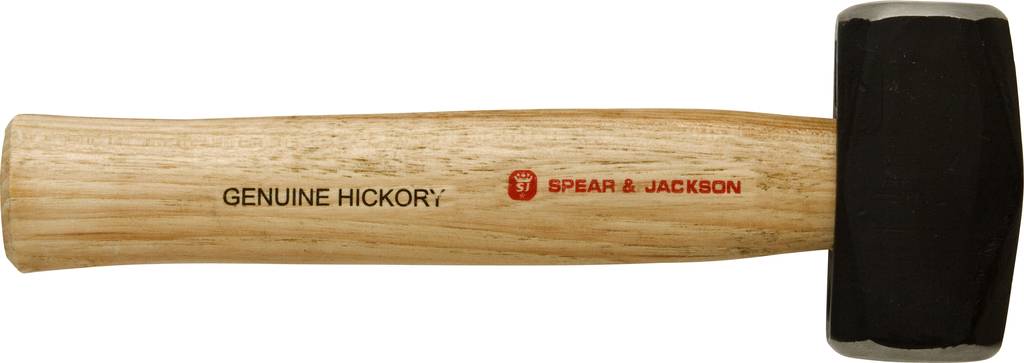

I learn a valuable lesson from my mentor/boss at 16. I still do it today.
He saw me shut the hood on a customer's car one day, came over, and whacked me on the head.
"Don't let me catch you doin that again." and then said, "WATCH!"
He stood on one side of the car and pulled down the hood with one hand up at the front and pushed down with the other hand at the back of the hood to keep it from "springing".
You didn't wanna spring a customer's hood working for Mike. Trust me.... View attachment 270881
So what keeps the other side from "springing"? You should have whacked Mike on the head and told him to get a life and stop brow beating his help over nonsense. He needlessly traumatized you. That explains a lot! :lol:
