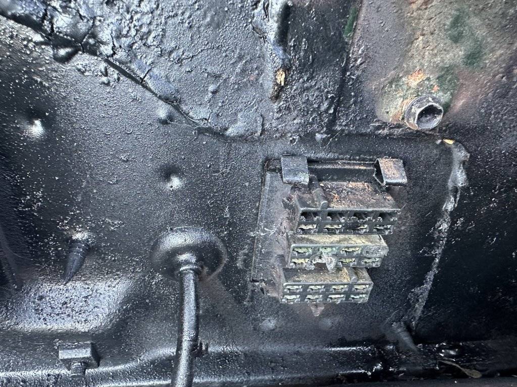

I just now seen that thanks so when I bypass amp meter do I tie both big wire together and run one from starter relay to hot side of ammeter 8 ga or 10 ga wire
If your ammeter is a problem, yes, tie the big wires behind it together.
I ran a 2nd 10 gauge wire from alternator output to starter relay battery terminal, so charge can run directly to the battery.
You then have 2 black charge wires coming off alternator output.
If you don't tie the wires behind the ammeter together, your ammeter will show discharge when charging system is not really discharging the battery.
