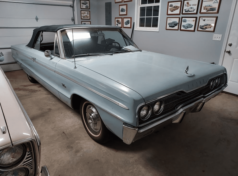

Just bought a 66 Polara convertible. Spent hours today getting rock hard tree sap off the hood and trunk. Paint isn't great, so I used lacquer thinner on the body. But the convertible top and plastic rear window are relatively new. What is a safe method for removing old hardened tree sap from the top material and plastic rear window?
