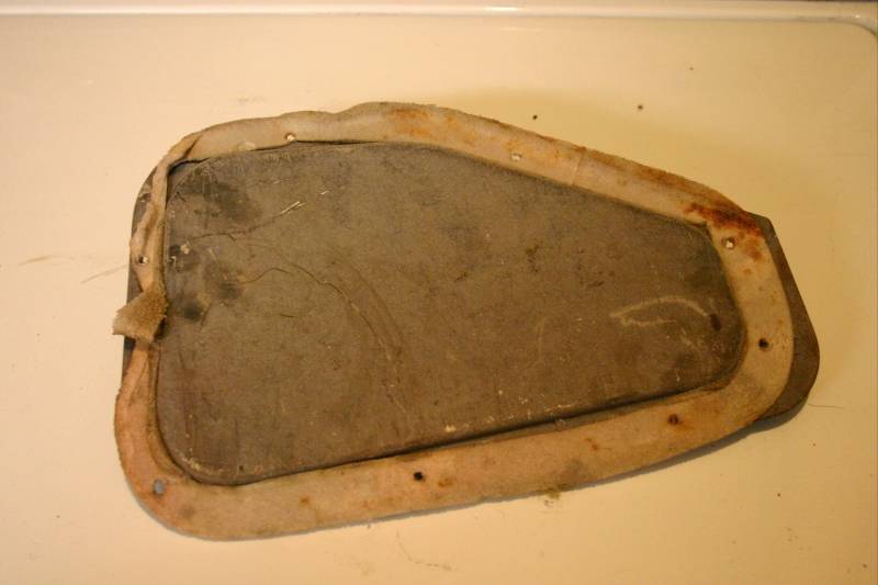

How do I open the air vent on the passenger side?
What happens when you follow the cable the other way?
What cable?
Has anybody seen one of these before?

1970 plymouth Fury
I see a cable to the vent but can't find a way to open it.
On the 1970 fury you will find there are two vent handles on the underside of the flat panel that covers the steering column and bottom of the dash on the drivers side. one for the left and one for the right
Thanks for the comments. I looked better and feel dumb. The passenger side just has a cover. There is a cable in there that does something else. Please forgive me.
No worries.
You really can't see it well from the driver's seat and sort of have to know its there. It's also such an arcane thing ( these were common up to about the advent of air conditioning in the 60's) that unless you really read the owners manual closely you'd never know these cars had them. They work well when the car is moving and on a cool dry day they're better than air conditioning.
