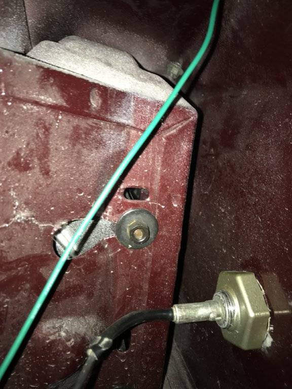

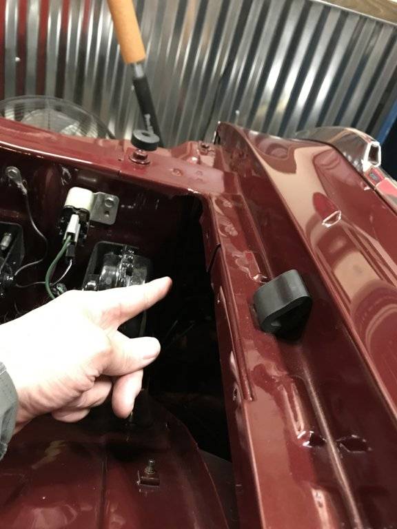

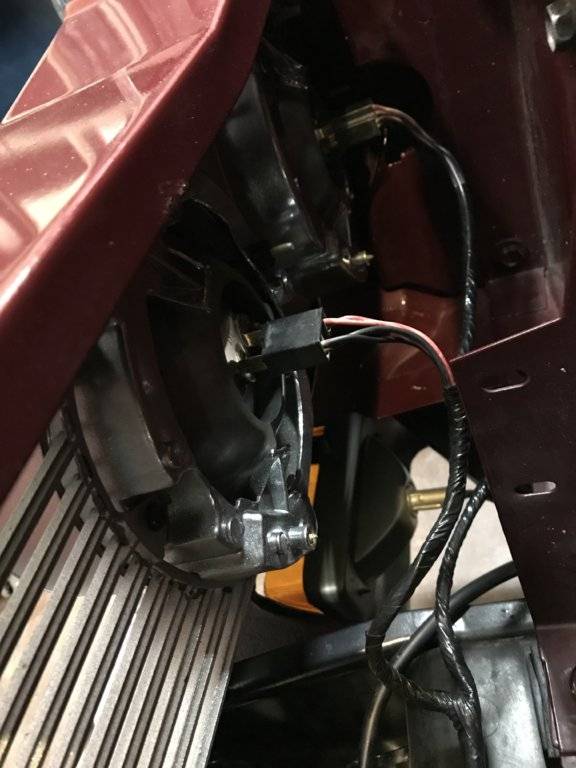

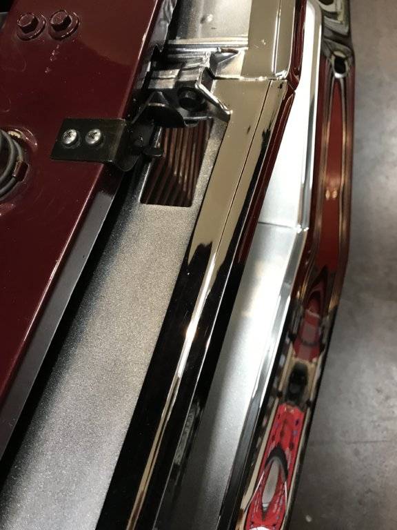

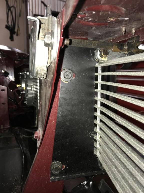

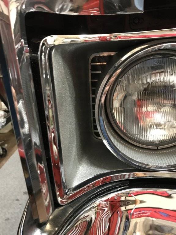

Apr 23, 2020 #4 HWYCRZR Old Man with a Hat FCBO Gold Member Joined May 13, 2015 Messages 5,175 Reaction score 7,011 Location Fargo, ND Here’s a ‘68 Polara, most likely a similar concept 6 bolts and the hood release and it should be ready to come out two nuts behind here in fender on each side. Will probably need to remove your washer bottle for the left side. 4 total. then 2 on the center support Don’t forget the hood release. And headlight plugs. If you have hidden headlights. I am probably no help.
