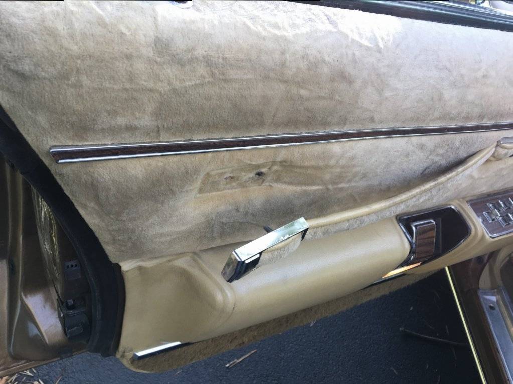

Oct 31, 2016 #1 Fast Eddie B Well-Known Member Joined Oct 16, 2016 Messages 605 Reaction score 630 Location Western New York i can't poke the screw through the velour without ruining it. Can't otherwise think about how it comes apart.
Oct 31, 2016 #2 Dobalovr Being on the Cbody diet SUCKS! FCBO Gold Member Joined Sep 3, 2015 Messages 5,693 Reaction score 7,698 Location Calgary Alberta The strap decor cover snaps onto the mount where the screw is. Seperate the cover from the mount screw the mount in snap cover into place
Oct 31, 2016 #3 Fast Eddie B Well-Known Member Joined Oct 16, 2016 Messages 605 Reaction score 630 Location Western New York Thanks man. Worked like a charm. I was afraid to start pulling on stuff lest they not go back together
