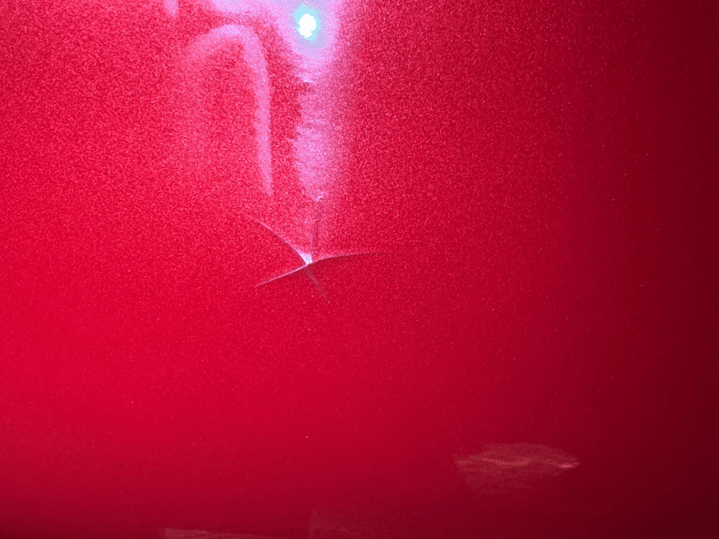

As a novice, I'd suggest you stay away from that one. For that much money, I would expect that the interior wouldn't be doctored up with a crappy dash and steering wheel covers to cover the cracked originals. Way too much spray on undercoating and a failing paint job. AC car, but it's all missing. Leaky rear end. That's just a quick look too. Not the stock color, the OE red has no metallic flakes and truthfully, if it's failing in one spot, it's gonna fail in others sooner or later. (probably sooner)

When I looked at the link, seeing that it is with a multi-merchandiser "broker", I didn't look at the selling price or other things. I did see the paint issue picture (better now that I have cleaned my glasses!) and THAT might be an issue down the line. I also noticed the deep spray can undercoat, which is thicker than Chrysler ever did it. THAT can be hiding something, too. I noticed the "dash cover", but was not that concerned about it, especially if it was done "years ago" by a trim shop who might not have known they could be re-done to look as they should look.

As to the "getting in over your head" issue, you need to find out just what has been done to the engine, the transmission, etc. While parts are available to fix those things, it can also get expensive quickly. The hidden bodywork can be problematic, sometimes. That crack in the paint didn't happen for no reason!
