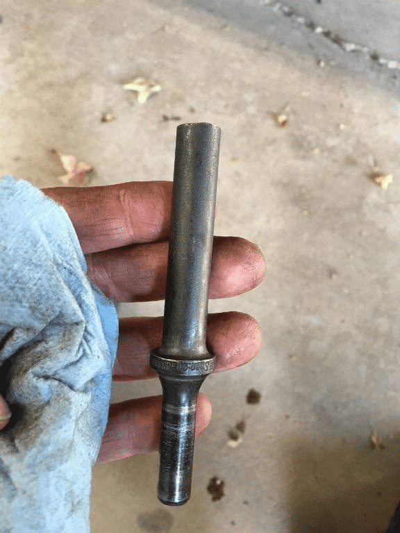

I used a broken air chisel bit, ground flat. Then I slipped a piece of 1/2" heater hose over it and used the air chisel to knock the studs out. No damage to anything, including the old studs.

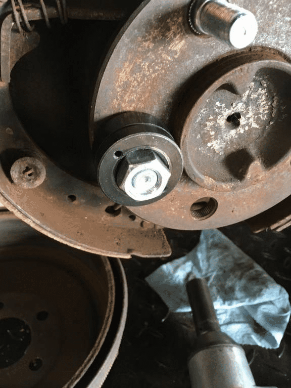

New studs were installed with a $10 tool I found on Amazon. The same could be done with some 1/2" washers and a little grease.
